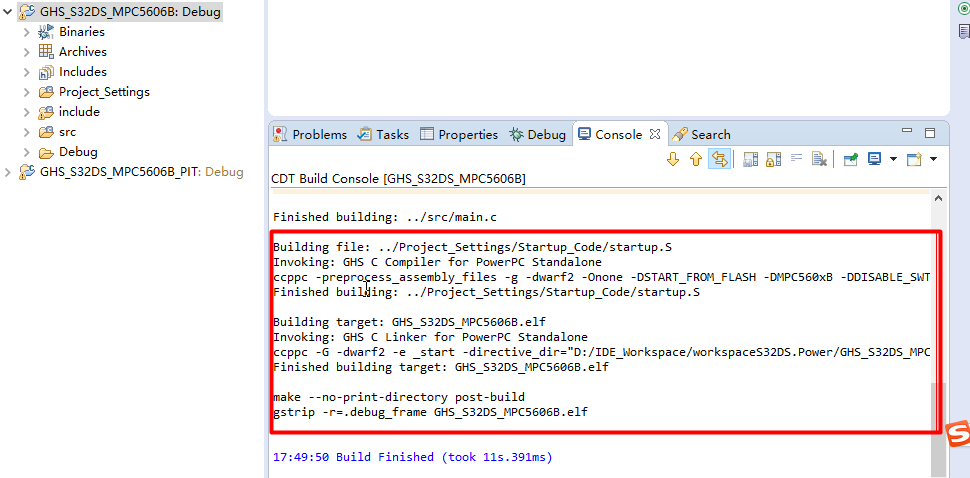

I have successfully integrated GHS Toolchain(for powerpc) in S32DS,
when I create a project ,it will prompt me to choos the Toolchain,As shown below:
when I choose the "GHS PowerPC Standalone Executable Toolchain",And build my project successfully:

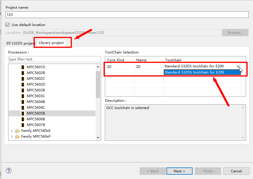

BUT When I want to compile a library file,I can not choose the GHS toolchain:
How do I use GHS Toolchain to build the library files(*.a file)  ??

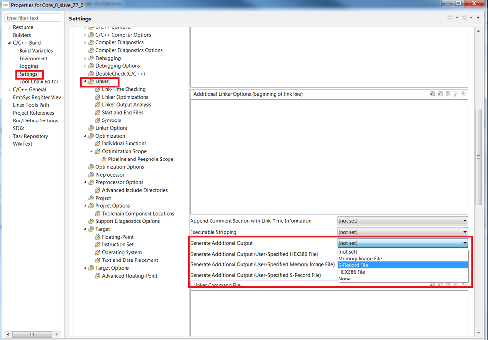

I use GHS Toolchain to compile my project can get the *.elf file ,but how do I generate a s-record file (S19 file)?

This is a known issue in S32ds ARM v1.3. This should be fixed in the next S32DS release.

stanish
This is a known issue in S32DS Power as well. This should be fixed in the next release/update.
Regarding GHS plugin: S-record generation could be setup in Project properties -> C\C++ Build -> Settings:
Hope it helps.
