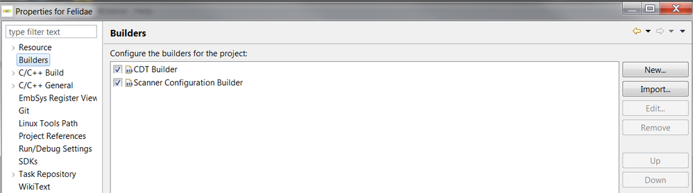

      I wrote a SCons script to build a S32DS project. My SCons script is able to build the project successfully when I call it in command prompt. I am wondering is there a way that I can add SCons as a new builder in S32DS? Instead of using current builders, I want to use my SCons script to build the project when I click the build icon in S32DS.
      Any help would be appreciated.

I have no experience with SCons - but it looks like that scons has some eclipse plugin. I found another howto to add scons into eclipse as a custom builder Here .  S32DS is based on eclipse 4.4 Luna.

Thank you for your help! It is extremely helpful. I solved it using the eclipse plugin.
