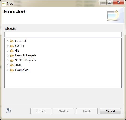

Hello everyone,

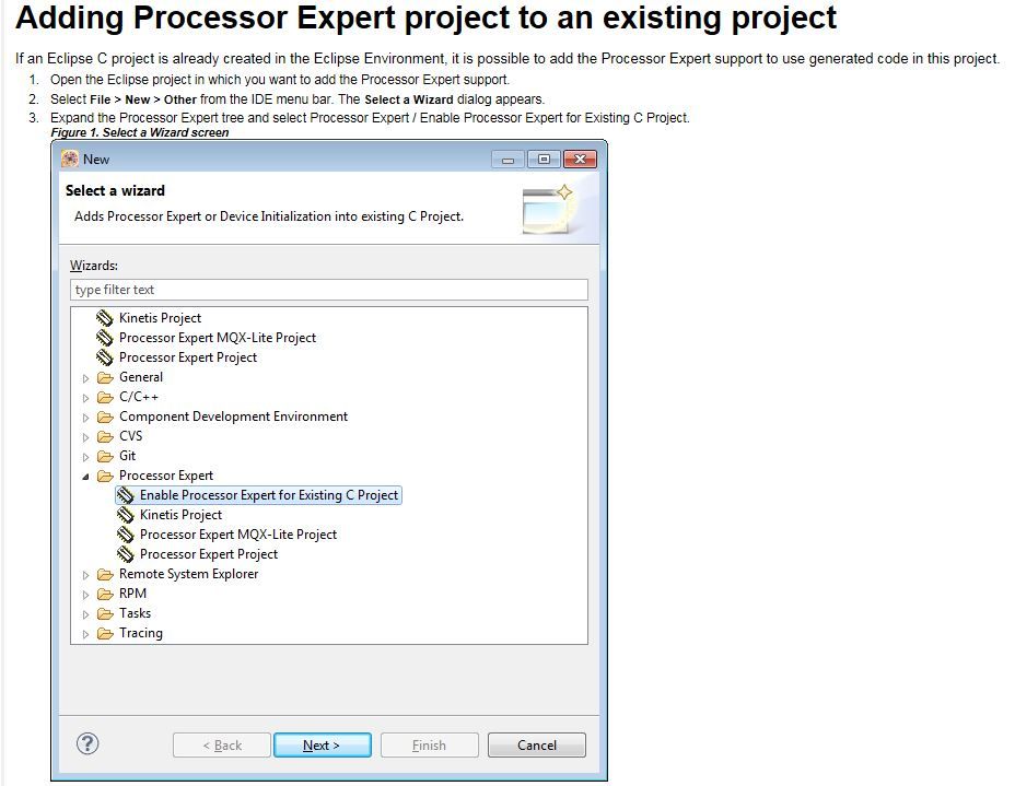

Today is my first day to use S32 Design Studio for ARM v2.0, I want to add Processor Expert project to an existing project according to the help like picture below:
But I can NOT find the Processor Expert folder, and my enviorment is like below:
Can you please tell me the reason? I have checked the installing information, nothing abnormal.

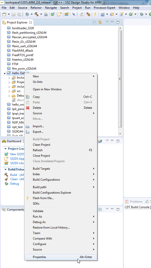

the "New Wizard" screenshot is probably from older S32DS version. Processor expert is part of SDK and you can add Processor expert with SDK. Right click on your project name -> Properties

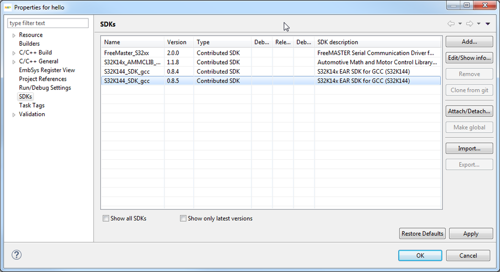

Select SDKs and choose one which you are interested in and click on Attach button:

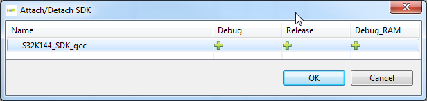

Check for which configuration you like to use SDK (probably for all)
and click on Apply and OK on Properties window. Processor expert should be ready for your project.

Thanks for your fast answer! and my problem is solved according to your suggestion.
Thanks again!
