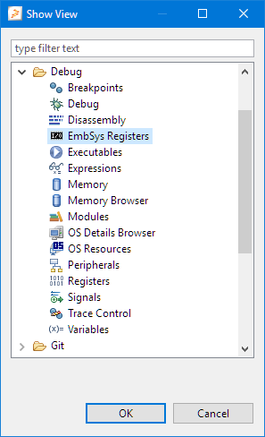

BlackNight
Hi Pietro,
there is EmbSys Registers view (menu Window > Show View > Other) you can use for inspecting the registers:
I hope this helps,
Erich

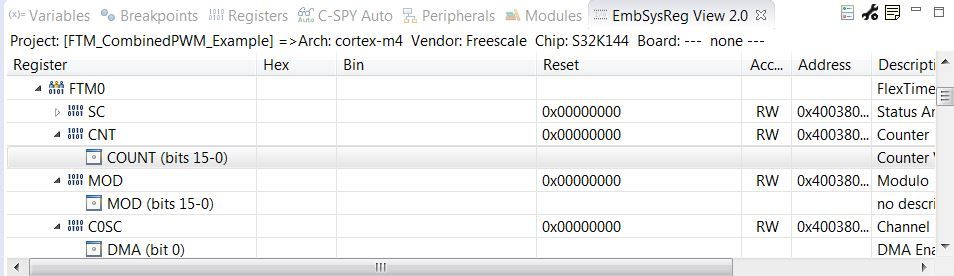

BlackNight
Hi Pietro,
you need to double click on the entries to read it.
There is an article with details about the original open source plugin and its usage here: How to Add Register Details View in Eclipse | MCU on Eclipse
I hope this helps,
Erich

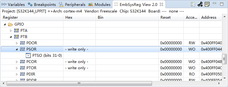

guoht
Hi Erich:
   How to change the registers value?It doesn't work when I changed one bit or more.
