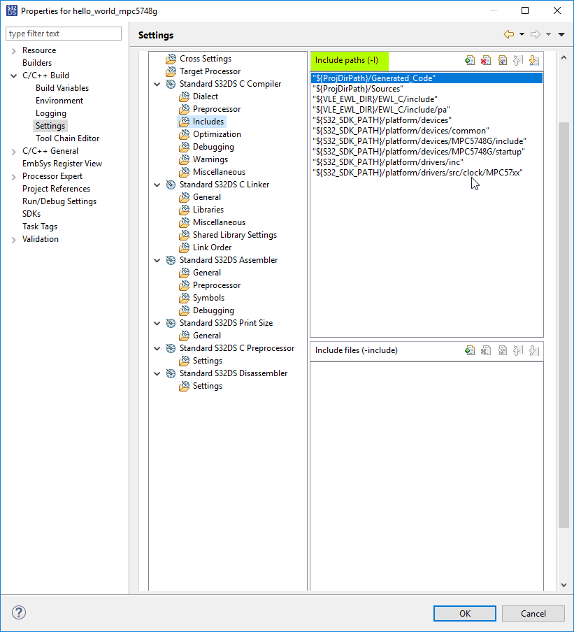

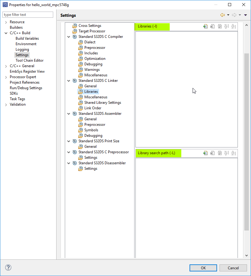

I'm not familiar with wolfssl - but I think this is just library like other ones. You have two options. If wolfssl provides library archive (.a file) built for MPC5748G - you can just add path to this library and library name in your project settings (right click on project name -> Properties) . Also don't forget add include path for wolfssl library header files:

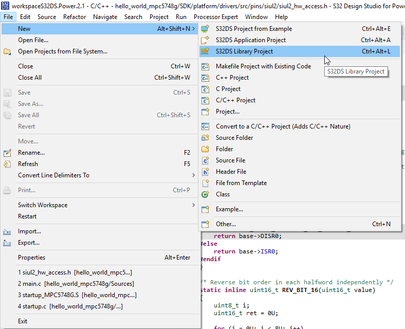

Second option is build library archive from source code for MPC5748G target. You need to create new library project, add source code into project and build it. Then continue with option 1.

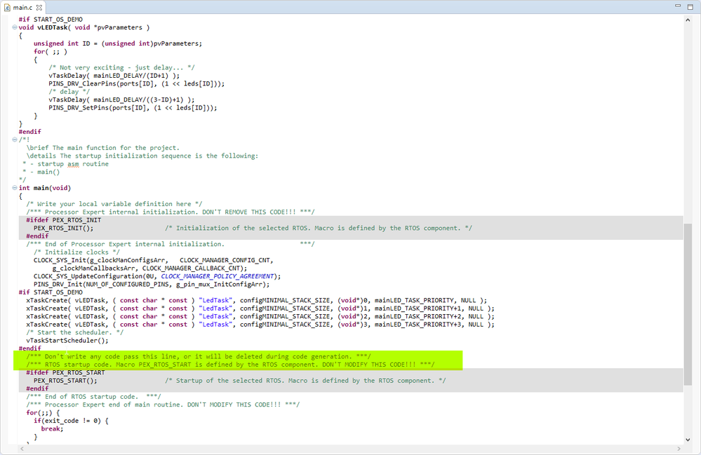

I see that in the example codes there're some codes that are not supposed to modify, so I'm not sure where I can insert my own codes. Just in the region which says "write your cod here" and "don't write any code pass this line"?
If I write my codes in the region aforementioned, it seems like the RTOS startup code is below my codes, but I need freertos in this case to run my own codes, so how should I modify that part of the codes specifically? Do I have to move that snippet of codes before my own codes?

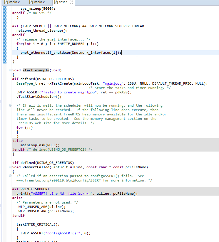

Also, what's the use of  function start_example() here?

So, you can modify any part of code above the highlighted line:
start_example() in lwip demo is used for starting example - if FreeRTOS is present - this startup code will start FreeRTOS task, otherwise infinite loop is started. You can navigate into function implementation by holding CTRL key and clicking on function name:
