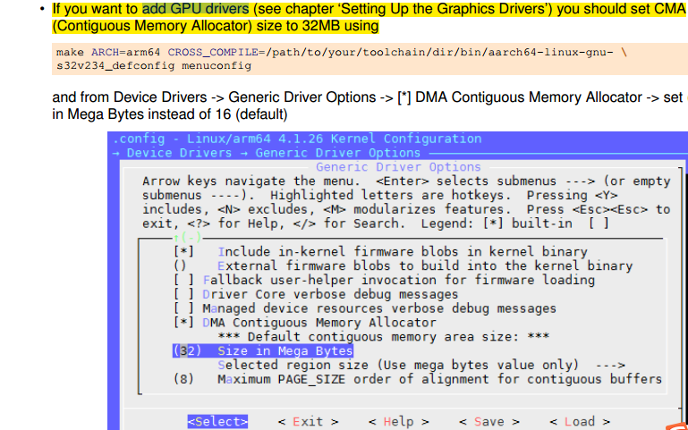

    I have a s32v234evb28899 borad in my commpany, and I found that I could use Linux BSP17.0 with the VSDK1.1.1。I used the uboot and linux Image created by the Linux BSP17.0(add patch from VSDK1.1.1)  as uboot and lmage. And I used the dtb and rootfs.tar.gz from VSDK1.1.1 's build_content 'v234_linux_build'. It worked well and I could use the demo elf from the vsdk.
   Unfortunately, I followed the user manual of Auto BSP17.0 to add GPU drivers. It caused that the VSDK drived modules failed to insmod. I just changed the menuconfig and setted CMA size to 32MB as below.
     Then the error log was:

root@s32v234evb:/s32v234# insmod apex.ko
[  250.228863] Unable to handle kernel NULL pointer dereference at virtual address 00000003
[  250.236627] pgd = ffffffc046397000
[  250.239958] [00000003] *pgd=00000000c5ce2003, *pud=00000000c5ce2003, *pmd=0000000000000000
[  250.248185] Internal error: Oops: 96000006 [#1] PREEMPT SMP
[  250.253719] Modules linked in: apex(O+) nxp sja1105pqrs(O)
[  250.259176] CPU: 1 PID: 881 Comm: insmod Tainted: G           O    4.1.26-rt29-dirty #3
[  250.267132] Hardware name: Freescale S32V234 (DT)
[  250.271808] task: ffffffc0462be3c0 ti: ffffffc045a60000 task.ti: ffffffc045a60000
[  250.279260] PC is at apex_probe+0x24/0x280 [apex]
[  250.283928] LR is at apex_probe+0x24/0x280 [apex]
[  250.288596] pc : [<ffffffbffc0382dc>] lr : [<ffffffbffc0382dc>] pstate: 20000145
[  250.295950] sp : ffffffc045a63ac0
[  250.299239] x29: ffffffc045a63ac0 x28: 0000000000000124
[  250.304517] x27: ffffffc045b8fc00 x26: ffffffc0000f91d0
[  250.309796] x25: ffffffc0464ac5c0 x24: ffffffbffc038bf0
[  250.315075] x23: 0000000000000006 x22: ffffffc04623d400
[  250.320354] x21: ffffffbffc038b18 x20: ffffffbffc038af0
[  250.325633] x19: ffffffc04623d410 x18: 0000000000000000
[  250.330912] x17: ffffffc000611200 x16: 0000000000000000
[  250.336190] x15: 0000000000000001 x14: ffffffc0451a890a
[  250.341469] x13: ffffffc0451a8909 x12: 0000000000000030
[  250.346749] x11: 0000000000000004 x10: 0101010101010101
[  250.352028] x9 : fffffffffffffff9 x8 : 7f7f7f7f7f7f7f7f
[  250.357308] x7 : fefefeff646c606d x6 : 0f121e0ce7eee5e4
[  250.362587] x5 : 64656e670c1e120f x4 : 0000000000000000
[  250.367867] x3 : 0000000000000140 x2 : 00000000000035b2
[  250.373146] x1 : ffffffc045a60000 x0 : 0000000000000000
[  250.378424]
[  250.379899] Process insmod (pid: 881, stack limit = 0xffffffc045a60028)
[  250.386476] Stack: (0xffffffc045a63ac0 to 0xffffffc045a64000)
[  250.392192] 3ac0: 45a63b00 ffffffc0 0039c80c ffffffc0 4623d410 ffffffc0 fc038af0 ffffffbf
[  250.400326] 3ae0: fc038b18 ffffffbf 00832000 ffffffc0 45a63b00 ffffffc0 0039c7f4 ffffffc0
[  250.408460] 3b00: 45a63b30 ffffffc0 0039b044 ffffffc0 4623d410 ffffffc0 00000000 00000000
[  250.416595] 3b20: fc038b18 ffffffbf 00832000 ffffffc0 45a63b70 ffffffc0 0039b27c ffffffc0
[  250.424730] 3b40: 4623d410 ffffffc0 fc038b18 ffffffbf 4623d470 ffffffc0 007e6670 ffffffc0
[  250.432865] 3b60: 007e6000 ffffffc0 003993ac ffffffc0 45a63ba0 ffffffc0 003993a0 ffffffc0
[  250.440999] 3b80: 00000000 00000000 fc038b18 ffffffbf 0039b1e0 ffffffc0 fc038bf0 ffffffbf
[  250.449134] 3ba0: 45a63be0 ffffffc0 0039aa68 ffffffc0 fc038b18 ffffffbf 466957c0 ffffffc0
[  250.457268] 3bc0: 00000000 00000000 0059d690 ffffffc0 0fd202a8 ffffffc0 461ab168 ffffffc0
[  250.465403] 3be0: 45a63bf0 ffffffc0 0039a6d8 ffffffc0 45a63c30 ffffffc0 0039b6a8 ffffffc0
[  250.473538] 3c00: fc038b18 ffffffbf 007c8e20 ffffffc0 451a8180 ffffffc0 fc03b000 ffffffbf
[  250.481672] 3c20: 00000000 00000000 45a63c70 ffffffc0 45a63c50 ffffffc0 0039c73c ffffffc0
[  250.489806] 3c40: 007c8e20 ffffffc0 007c8e20 ffffffc0 45a63c60 ffffffc0 fc03b018 ffffffbf
[  250.497941] 3c60: 45a63c70 ffffffc0 00081024 ffffffc0 45a63cf0 ffffffc0 005a05f4 ffffffc0
[  250.506076] 3c80: fc038ba0 ffffffbf 007d0000 ffffffc0 464ac5d0 ffffffc0 45eecd80 ffffffc0
[  250.514210] 3ca0: fc038ba0 ffffffbf 45eecd80 ffffffc0 00000001 00000000 00000001 00000000
[  250.522346] 3cc0: 45a63cf0 ffffffc0 005a05c0 ffffffc0 fc038ba0 ffffffbf 007d0000 ffffffc0
[  250.530480] 3ce0: 464ac5d0 ffffffc0 00000001 00000000 45a63d20 ffffffc0 000fc1c4 ffffffc0
[  250.538615] 3d00: 45a63e68 ffffffc0 00000001 00000000 464ac5d0 ffffffc0 00000001 00000000
[  250.546749] 3d20: 45a63e30 ffffffc0 000fc8b8 ffffffc0 00000000 00000000 00000003 00000000
[  250.554883] 3d40: 00419550 00000000 9485b9c4 0000007f 80000000 00000000 00000015 00000000
[  250.563018] 3d60: 0000011a 00000000 00000111 00000000 005ac000 ffffffc0 45a60000 ffffffc0
[  250.571153] 3d80: 45a63e30 ffffffc0 45a63de8 ffffffc0 006e8280 ffffffc0 00000003 0000006e
[  250.579287] 3da0: 0000003f ffffffbf 0000feff ffffff80 0000fff1 ffffff80 005b5368 ffffffc0
[  250.587422] 3dc0: fc03b048 ffffffbf 45a63e28 ffffffc0 0000000f 000081a4 00000001 000003e8
[  250.595556] 3de0: 000003e8 00000000 0004d118 00000000 5b7b88ba 00000000 00000000 00000000
[  250.603690] 3e00: 00000000 00000000 00000000 00000000 00000000 00000000 00000000 00000000
[  250.611825] 3e20: 00000000 00000000 00000000 00000000 e5a2cc30 0000007f 00084470 ffffffc0
[  250.619960] 3e40: 00000000 00000000 1bcba780 00000000 ffffffff ffffffff 00000000 00000000
[  250.628095] 3e60: 45a63ec0 ffffffc0 01312000 ffffff80 0004d118 00000000 0135e818 ffffff80
[  250.636230] 3e80: 0135e6c8 ffffff80 0133b2c8 ffffff80 00000e58 00000000 00001230 00000000
[  250.644364] 3ea0: 00000000 00000000 00000000 00000000 00001050 00000000 00000022 00000023
[  250.652499] 3ec0: 0000000e 00000000 0000000a 00000000 00000003 00000000 00419550 00000000
[  250.660633] 3ee0: 00000000 00000000 00000003 00000000 00000000 00000000 ffffffff 60ceffff
[  250.668768] 3f00: ffffffff ffffffff ffffffff ffffffff 00000111 00000000 00000005 00000000
[  250.676902] 3f20: 01010101 01010101 00000001 00000000 00000000 00000000 00000000 00000000
[  250.685038] 3f40: 94928700 0000007f 0000073f 00000000 9485b9a0 0000007f 0042a618 00000000
[  250.693173] 3f60: 00000000 00000000 00419550 00000000 1bcba780 00000000 00000000 00000000
[  250.701307] 3f80: 00000000 00000000 00000000 00000000 00000000 00000000 00000002 00000000
[  250.709442] 3fa0: 00000000 00000000 00000000 00000000 00000000 00000000 e5a2cc30 0000007f
[  250.717577] 3fc0: 004108c4 00000000 e5a2cc30 0000007f 9485b9c4 0000007f 80000000 00000000
[  250.725712] 3fe0: 00000003 00000000 00000111 00000000 00000000 00000000 00000000 00000000
[  250.733840] Call trace:
[  250.736273] [<ffffffbffc0382dc>] apex_probe+0x24/0x280 [apex]
[  250.741984] [<ffffffc00039c80c>] platform_drv_probe+0x4c/0xb8
[  250.747692] [<ffffffc00039b044>] driver_probe_device+0x16c/0x2b0
[  250.753660] [<ffffffc00039b27c>] __driver_attach+0x9c/0xa0
[  250.759112] [<ffffffc0003993a0>] bus_for_each_dev+0x60/0xa0
[  250.764650] [<ffffffc00039aa68>] driver_attach+0x20/0x28
[  250.769928] [<ffffffc00039a6d8>] bus_add_driver+0x150/0x208
[  250.775467] [<ffffffc00039b6a8>] driver_register+0x60/0x120
[  250.781006] [<ffffffc00039c73c>] __platform_driver_register+0x5c/0x68
[  250.787414] [<ffffffbffc03b018>] ApexInit+0x18/0x48 [apex]
[  250.792864] [<ffffffc000081024>] do_one_initcall+0x8c/0x1a8
[  250.798401] [<ffffffc0005a05f4>] do_init_module+0x5c/0x1a4
[  250.803854] [<ffffffc0000fc1c4>] load_module+0x17f4/0x1c88
[  250.809304] [<ffffffc0000fc8b8>] SyS_finit_module+0xc8/0xd8
[  250.814843] Code: 9100f3a2 58001041 f940fc00 9510dcd0 (39c00c15)
[  250.820984] ---[ end trace fee402510e2c9983 ]---
Segmentation fault
In addition, if I didn't set the CMA size, the right log was as below:
U-Boot 2016.01+g61ddb5d (May 28 2018 - 11:51:10 +0700)
CPU: NXP S32V234 V1.0 at 800 MHz
Reset cause: External reset
Board: s32v234evb28899
I2C: ready
DRAM: 256 MiB
All (4) cores are up.
MMC: FSL_SDHC: 0
Setting PCIE Vendor and Device ID
Forcing PCIe to Gen1 operation
phy link never came up
DEBUG_R0: 0x0071d600, DEBUG_R1: 0x08200000
In: serial
Out: serial
Err: serial
The security module (CSE3) is disabled.
Net:
Warning: System is using default MAC address. Please set a new value
FEC
Hit any key to stop autoboot: 0
=> run nfsboot
Booting from net using tftp and nfs...
Using FEC device
TFTP from server 192.168.1.30; our IP address is 192.168.1.35
Filename 'Image'.
Load address: 0x8007ffc0
Loading: #################################################################
531.3 KiB/s
done
Bytes transferred = 7833088 (778600 hex)
Using FEC device
Filename 's32v234-evb28899.dtb'.
Load address: 0x82000000
Loading: ##
470.7 KiB/s
done
Bytes transferred = 21698 (54c2 hex)
## Flattened Device Tree blob at 82000000
Booting using the fdt blob at 0x82000000
reserving fdt memory region: addr=80000000 size=10000
Loading Device Tree to 000000008fd64000, end 000000008fd6c4c1 ... OK
Starting kernel ...

1 解答
4,804 次查看
nxa13002
Did you rebuild VSDK drivers ? . You need to rebuild VSDK drivers after you build Image and dtb
在原帖中查看解决方案
10 回复数
4,804 次查看
nxa13002
Hi ,
I have tried with bsp18_rc7 using following steps:
- make ARCH=arm64 CROSS_COMPILE=aarch64-linux-gnu- s32v234_defconfig
- make ARCH=arm64 CROSS_COMPILE=aarch64-linux-gnu- menuconfig
then follow GPU enable instruction above.
Apply Patch from VSDK
- patch -p1 -i $(SDK_ROOT)/os/linux/0001-s32v234-dts-Add-VSDK-specific-configuration.patch
Then build vsdk drivers and galcore driver. It can insmod all vsdk drivers and galcore driver
4,804 次查看

To get bsp_18 rc7 do following steps:
  - Go linux repo
 - git fetch
- git checkout [tag_bsp18]
But I think that you can insmod galcore with bsp17 with the steps:
And make sure that you have to build again all vsdk drivers and galcore driver

[ 5.468928] Internal error: Oops: 96000006 [#1] SMP
[ 5.473765] Modules linked in: apex(O+)
[ 5.477583] CPU: 3 PID: 689 Comm: insmod Tainted: G O 4.14.34-rt27+g5b7d979 #2
[ 5.485892] Hardware name: Freescale S32V234 (DT)
[ 5.490570] task: ffffffc0469a4280 task.stack: ffffff8009c68000
[ 5.496469] PC is at apex_probe+0x24/0x3d8 [apex]
[ 5.501143] LR is at apex_probe+0x24/0x3d8 [apex]
[ 5.505814] pc : [<ffffff80005f02b4>] lr : [<ffffff80005f02b4>] pstate: 20000145
4,805 次查看
nxa13002
4,804 次查看
zhangweikanghus
Thank you I didn't rebuild it. I will try it soon.
