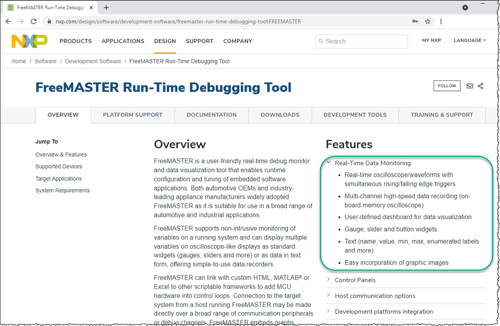

As far as I know, currently S32DS does not support this function, but you can use FreeMASTER to achieve it.

Real Expressions monitor is PE Micro plugin and there is no record feature (may be PE Micro add it in future).
As Robin mentioned - FreeMaster is one possibility. Other one is using Segger J-Link debug probe and use J-Link scope tool.

Sorry for my late reply, thank you for providing another possibility by using Segger J-Link debug probe and use J-Link scope tool. but it's very pity I currently only have PE Multilink. I didn't find PE Micro plugin with record function before, but now FreeMaster tool can help me, thank you!

I'm sorry for my late reply, this tool is very helpful, thank you!
