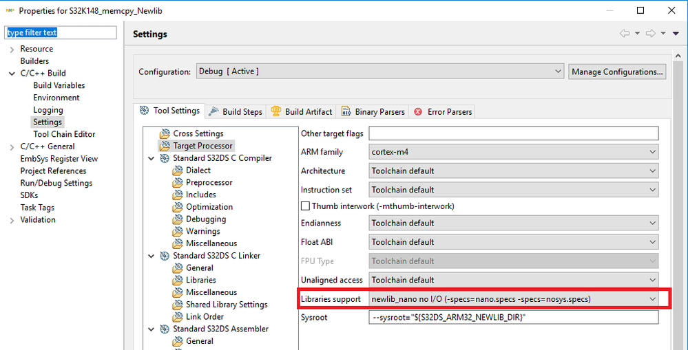

stanish
Lutz,
I suspect you are linking with a different lib selected.
The linker script file must match with the project settings:
Please make sure you are using newlib_nano library in Target Processor settings + you refers to  newlib_nano in .ld file.
Attached is an example project that I used.
Stan
