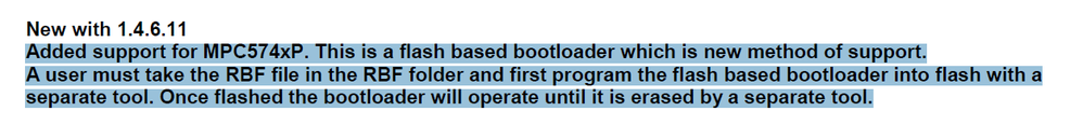

And then I founded that the Release Notes says I should download the bootloader file into the flash firstly.
But where shall I get the bootloader file, and how can I download to the flash?

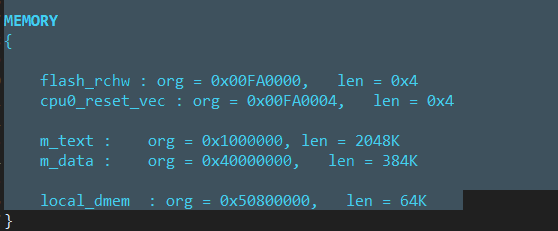

I guess it is because the start address in my linker file is not modified, and the rbf file has been overwritten.
So I read your reply for another question.
https://community.nxp.com/message/1032292
But after reading my linker file, I found my linker file different with the file in that question.
So I don't know how to modify it , to make it match the rbf file.
Could you please help me?

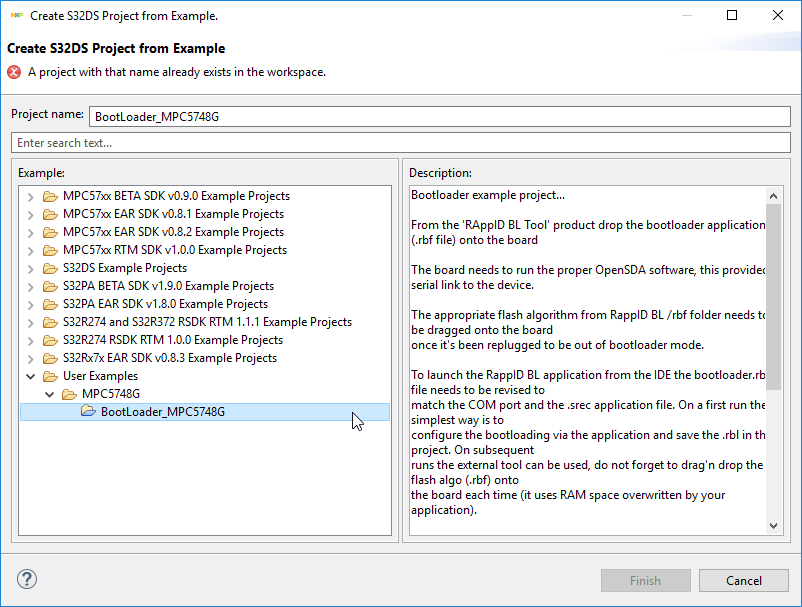

jiri_kral

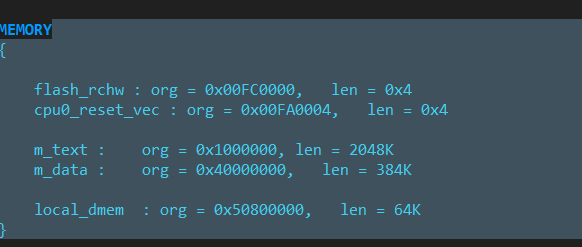

please look at boot loader example for MPC5748G. Basically - move your start address from 0xFA0000 to 0xFC0000.

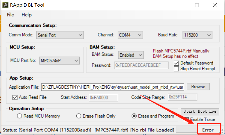

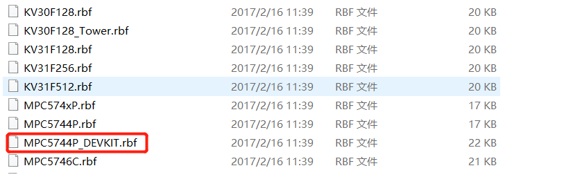

Firstly, I have done as the following link recommended by you:
HOWTO: Use RappID BL tool with MPC5744p EVB
The rbf file is as fellow.

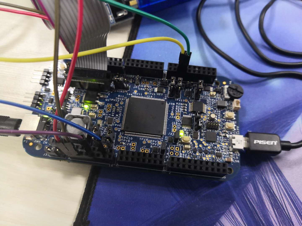

I improt a "helloworld" example project into the S32 DS workplace, and put the rbf into the project.
And I use the multilink fx to flash the rbf file into the MCU

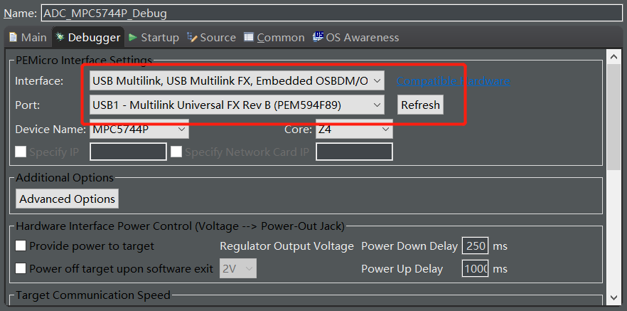

and my devkit-MPC5744P is as fellow:

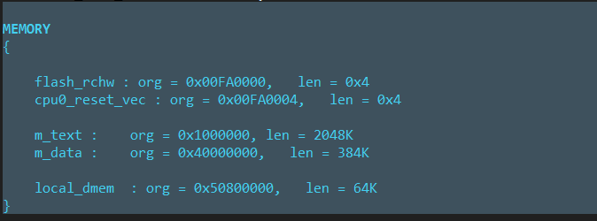

The start address of link file "57xx_flash.ld " in "linker_files" folder  in the "helloworld" project :
AND then I compile the "linflexd_uart_mpc5744p" example project, and modify the linker file start address. After that the srec file was generated.
But I found that the I can flash the srec file once ,but not the second time.
And sometimes just after reflashing the rbf file into the MCU, the Bootloader also cannot work.The message window is as the fellow:
The problem is still on.

By the way:
May I ask what the "Bootloader_Mpc5748G" project is used for, to flash the rbf file or flash the application?

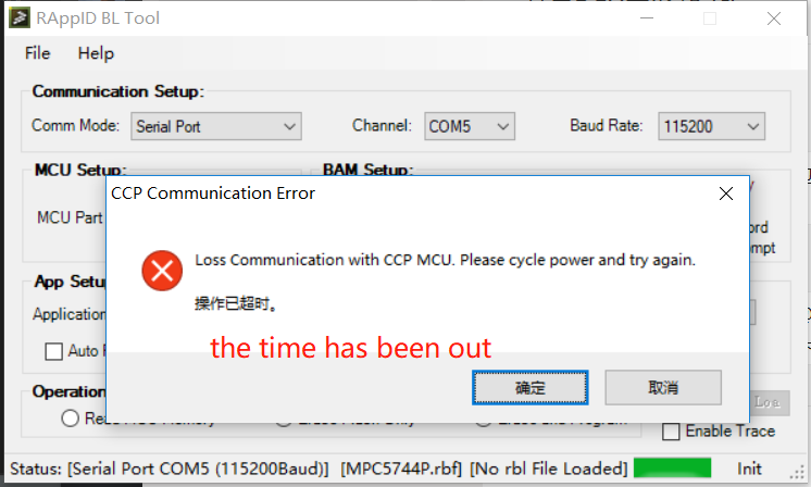

Secondly, I ignored the warning and build the project , which creates *.srec file. And then I debug the *rbf file into the MCU, open the RappID Bootloader, flash the *.srec file into the MCU.
I do the above as the howto doc says, it is successful. The user LED flash and change colour which shows  "Helloworld_PLL_Interrupt" project works.
However, it is failed if I wanna flash the *.srec file again, where the messagebox says "the time has been out".
After that I wanna flash the *rbf file into the MCU again, the debug process goes well but the result shows it is also failed. Because the userLED is still flashing and changing color.
And I found that I need to flash another project , for example, S32 example project "ADC_MPC5744P", into the MCU to clear the MCU flash. After it I can debug the *rbf file and flash the *.srec file into the MCU successfully.
It is so weird that I cannot understand.
Some questions:
  1. After debugging a project into the MCU with S32ds, has all the flash space been cleared? (no matter what project)
  2. Shall we modified the linker file of application? I guess the rbf file has been overwritten.
  3. Is there any available description document for the MPC5744P.rbf ?

jiri_kral
your issue is probably caused by boot loader timeout (3 sec). When you like to flash another s-record - press reset button on EVB right before you start uploading from RappID BL tool.

1506840872
It does work indeedly, thank you.

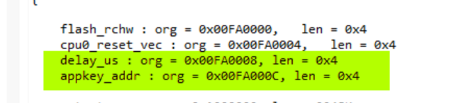

And I wonder if there is any document to describe the function of some key words. For example, why shall we add some key words like "appkey_addr", as the picture shows below ?
