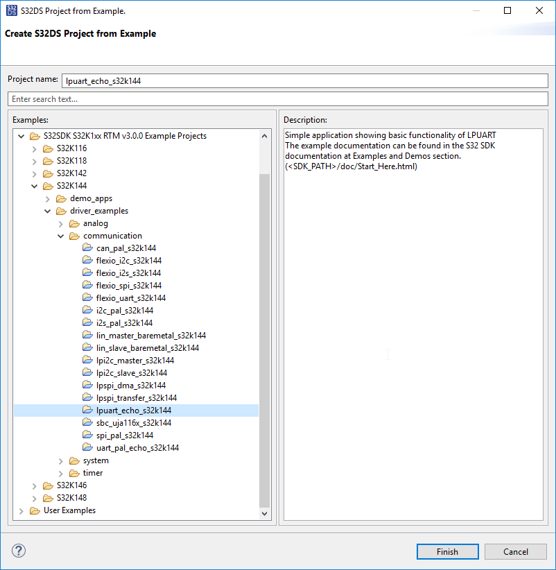

HI ,when i use s32k144 lpuart,To reduce frequent interruptions, i want use fifo and dma ,
how can i use it?
1,010 Views
jiri_kral
there is SDK example for UART using DMA. You can use it as a reference:
Hope it helps.
Jiri
