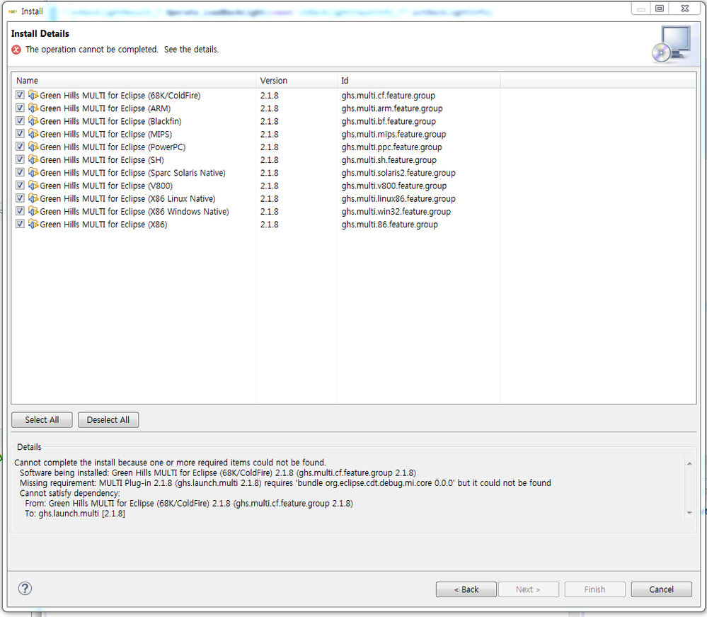

Some errors occurred when I try to install GHS plug-in as below in S32DS 2018 R1 for ARM, could you check about it?
And is there GHS plug-in install guidance material?

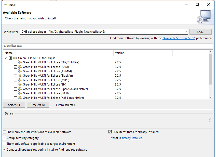

Indeed you will  need a newer version of GHS plugin supported by neon v2.2.5+. See below:

If you already have GHS plugin compatible with Eclipse Neon - try to remove support for 68K/ColdFire - if you don't need it.. The error message looks that is related to this part only.

Hi leekate-b45752‌,
The GHS Plugin does not support Eclipse Neon. S32 Design Studio for ARM migrated to Eclipse Neon in Release 2018.R1. If a user wishes to use the GHS Plugin on Eclipse Neon, then they must contact GreenHills support.
