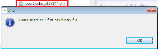

I'm tring examples in S32DS for a S32K144 chip. I checked how can I make the *.bin file in this community ( How to convert *.elf to *.hex file  ) and I completed to make a bin file.
However, I couldn't flash this binary file to S32K144 directly in S32DS v2.0 as below figure.
Please let me know how I can flash the bin file directly.
Thank you,
BR, Seunghyun Um
3,180 Views
jiri_kral
unfortunately PE Micro is not supporting raw bin file flashing. You can use srec,hex or elf. The feature (bin file output) can be used in linker file (e.g. https://community.nxp.com/message/945930?commentID=945930#comment-945930 )
