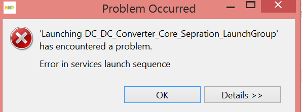

rahulmankumbare
We tried with the suggested steps.
But we are getting error.
"Error in services launch sequence"
Please guide.
Thanks.
Rahul
2,489 Views
jiri_kral
can you please click on details button and share the message?
Jiri
2,489 Views
rahulmankumbare
Following is the details of error.
Following immage shows the server settings in current project.
Please suggest mistakes.
Thanks.
Rahul.
2,489 Views
jiri_kral
you are probably starting second instance of gdbserver by Z7_1 debug. Please check if Z7_1 debug isn't starting gdbserver (screenshot is taken from S32R274 - but it is very similar as your MCU).
and also Z7_1 is only attaching to running server:
Jiri
2,489 Views
rahulmankumbare
we are able to debug core1.
Thanks.
