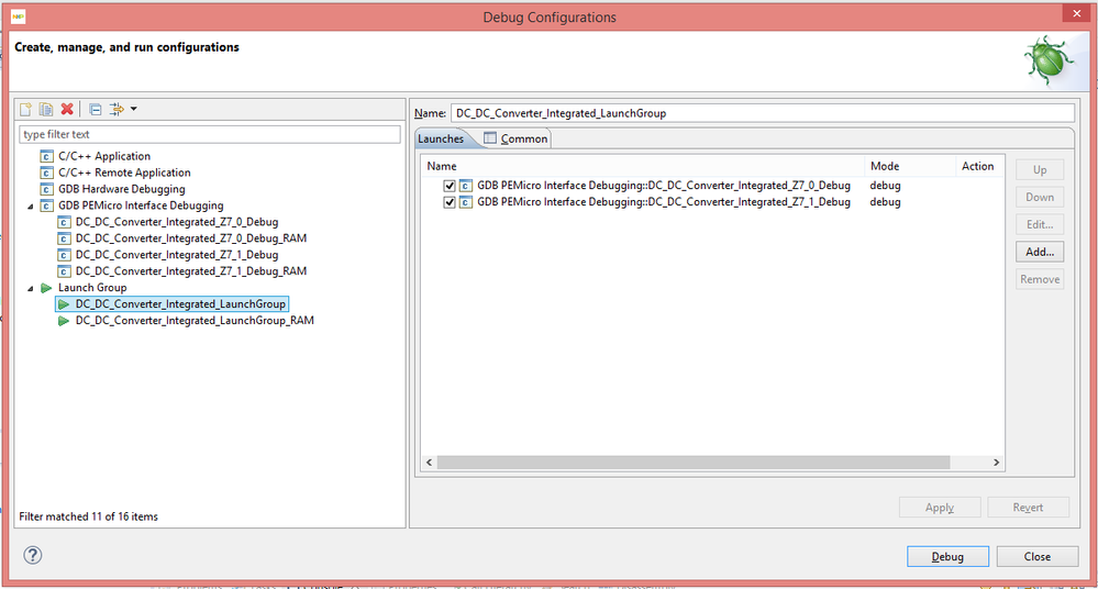

i am using flash from file for flash configuration but there i can only debug either core 0 or core 1 but not both simultaneously. I want to flash both core 0  and core 1 simultaneously.
I am to debug both core 0 and core 1 simultaneously by using below debug configuration.

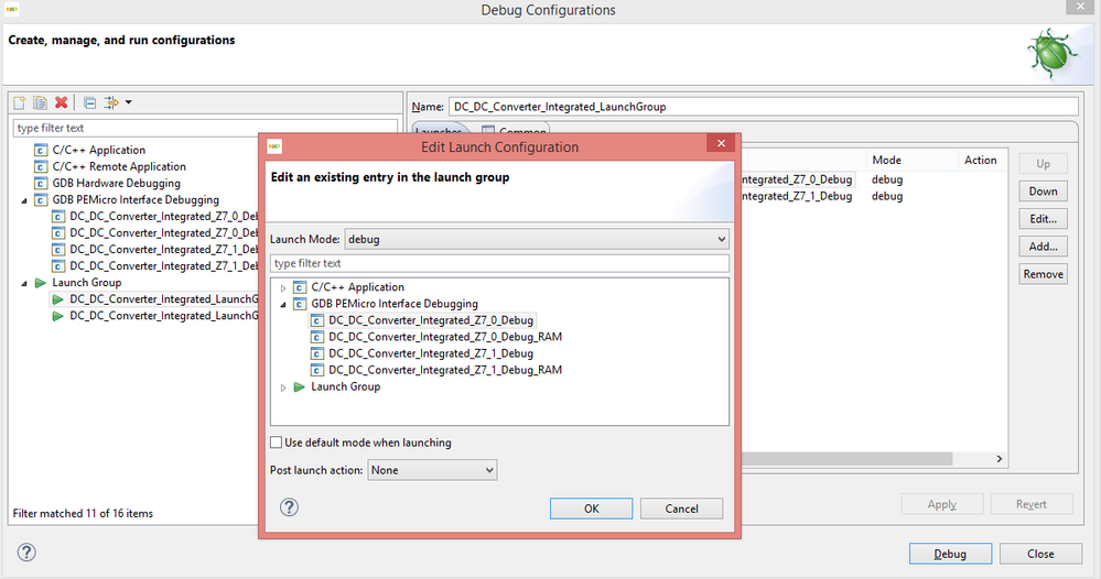

here we are using launch group in debug mode we are easily able to debug both core simultaneously. here is option to edit launch group having below configuration.
there we can change launching mode from debug to flash like this
i have also try this option for flashing the code but it also fail means flashing not done properly and it stuck somewhere.
so please suggest me how to flash both core 0 and core 1 simultaneously in MPC5777C using S32 design studio?

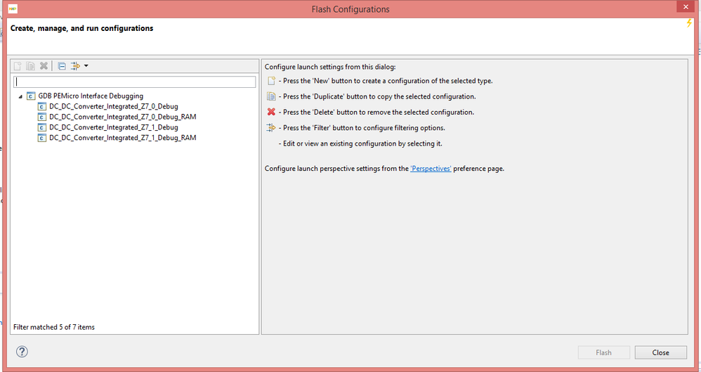

Flash Configurations are not intended for debugging but just for programming the MCU.
In order to program the multicore (multi-elf) project you should select the boot core debug/flash configuration:
The boot core debug/flash configuration contains all the executable files for all the cores:
Regarding multicore debugging -  there is a Launch group that program the elf(s) and starts a single debug session with multiple independent cores - debug threads.

Actually - PE Micro debugger is primary dedicated for debugging - not for flashing only. But there is one possibility how to flash code only. You can try this steps:
Click on Flash icon on tool bar:
and click to Flash button:
Target is flashed and dbg server is shut down.
Jiri
