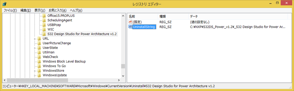

danjiang
Hi Jiri,
Thanks for your reply.
I tried to add a new entry manually follow your path, and it was successed.
After edited registry I reboot the OS and try to install S32DS again, but the same error occured.
Is there any problem related to 64bit-OS ?
Dan

jiri_kral
I tested it on 64bit Win 10 - and had no issue. Can you please share full log file? I'll send it to Installer team.May be they will find something. I have no idea what else may be wrong.

jiri_kral
I'm not able reproduce your issue. On the error message I can see that installer is executing ping command - are you able start ping manually from command line?
Also the access denied message in the log may be related to some special characters in the install path - there is couple question on community related to Chinese encoding and S32DS - but I'm afraid that  there is no universal solution yet.
