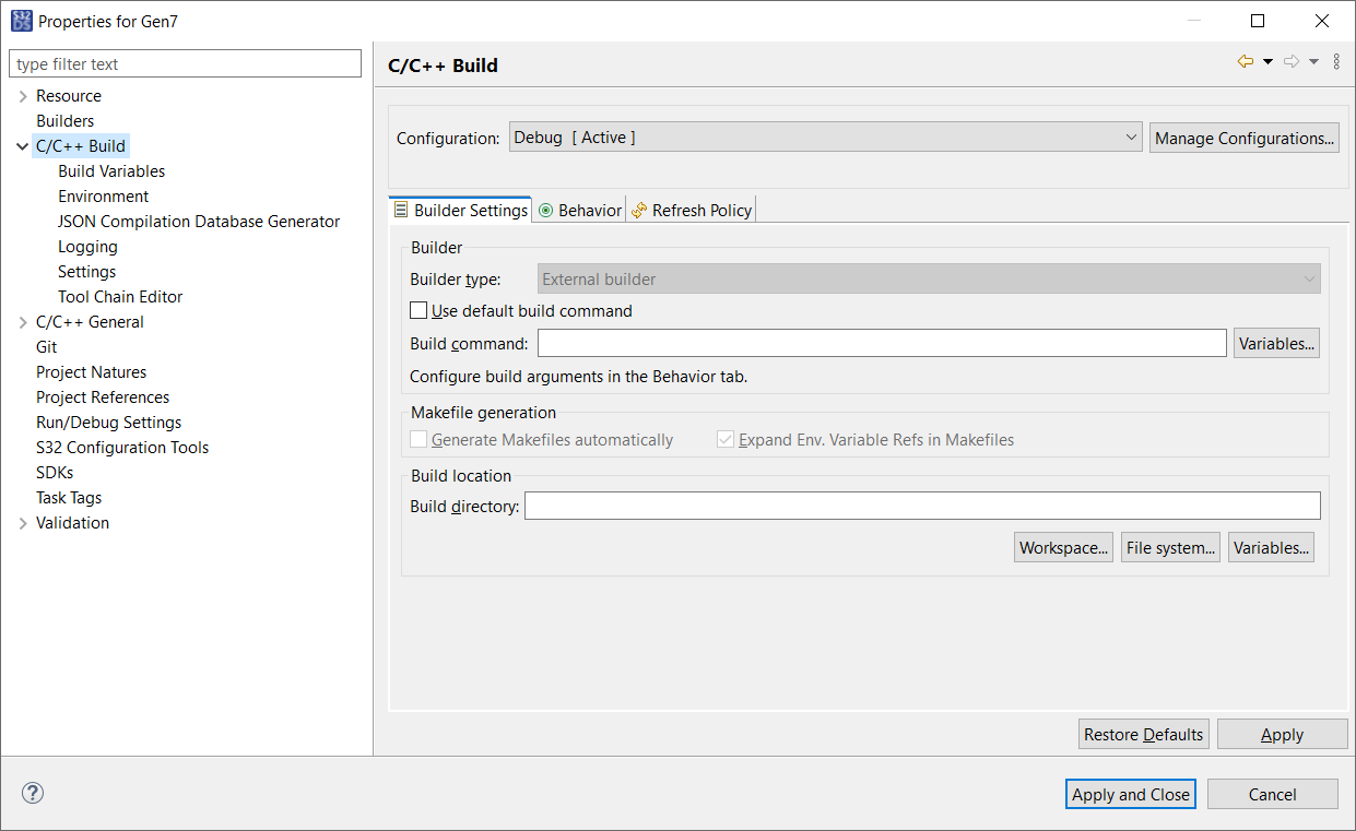

Hello NXP,
after installation of S32DS 3.6.0, seems that the external builder (for a makefile project) doesn't work, my *.bat files are not called by the IDE. Same setting works correctly in 3.5.0.
I have tried absolute/relative paths but no reaction from IDE.
I use the OS Window 10 Enterprise 22H2 x64.
Could you please tell what should be done to use the external builder ?

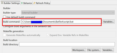

Hi @Andrei_G ,
I have tested these settings and noticed that the .bat file is called correctly in S32DS 3.5, but in S32DS 3.6 the file is not called, and no output is displayed in the console. Nevertheless, as a workaround, if it is not inconvenient, you can also specify the path in Build Command option, to ensure it runs every time.

Andrei_G
Hello @IsaulO,
there is no error in console (and nothing is done): Build Finished. 0 errors, 0 warnings. (took 8ms)
Also, I cannot use the hints described on "MCU on Eclipse" portal, because in a "makefile project" the compiler settings are not available.

Andrei_G
Hello @IsaulO,
thank you for the analysis. By adding another batch to the "Build command" field with the "call %*" content also works as in 3.5.0.
