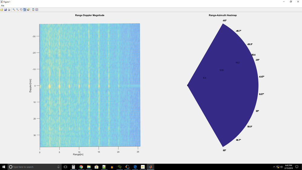

sushant_sg
Hi Cristian,
Thanks for reply.
We tried the SPT Kernel suggested in the reply, and analyzed the data in matlab.
We are constantly getting the peak at the distance of 2.5 meters after range FFT irrespective of physical location of object.
We even tried continuous mode that is "NR_FRAMES" in rru_config_0.ini file set to 0. But when we are running the RunRadarApp_S32R274.exe application file we are getting the peaks at every 2.5 mtrs( Screeshot of the same is attached here with). There is no change in the given screenshot, even the object is moved at various locations.
I am attaching the data folder for both continuous mode run with default SPT kernel provided in the code and for run ("NR_FRAME = 5") with the SPT kernel (ADCSampleAcq_512smp_128crp.pspt).
We are hoping that you can help us to resolve this issue and get this example project running.
Thanks & Regards,
Sushant Gosavi.

b41937
Hi Sushant,
You are configuring the front end to alternate between Tx1 and Tx2 every chirp (pre-requisite for MIMO) but you are processing the signal with non-MIMO SPT kernels (512x128). Select TX_CH_ENABLE as 0 all the time.
Tudor

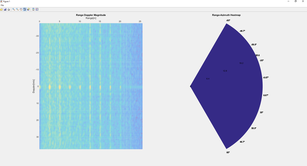

sushant_sg
Hi Tudor,
Thanks for replying.
We tried the configuration changes you suggested.
But still we are getting same output in the continuous mode, (NR_FRAMES == 0)
I am sharing the Screenshot of the same (after running RunRadarApp_S32R274.exe  file) with this reply.
I am also sharing the data folder for your reference (for both "NR_FRAMES ==0" and "NR_FRAMES == 10").
Please help us to run this example project.
Is there any TEF810B specific RADAR example project with S32R274?
If yes can you tell me where to find it?
Thanks & Regards,
Sushant Gosavi.
2,884 次查看
b41937
The issue you were seeing was a TEF810X driver issue that was fixed in RSDK 1.2.1.
