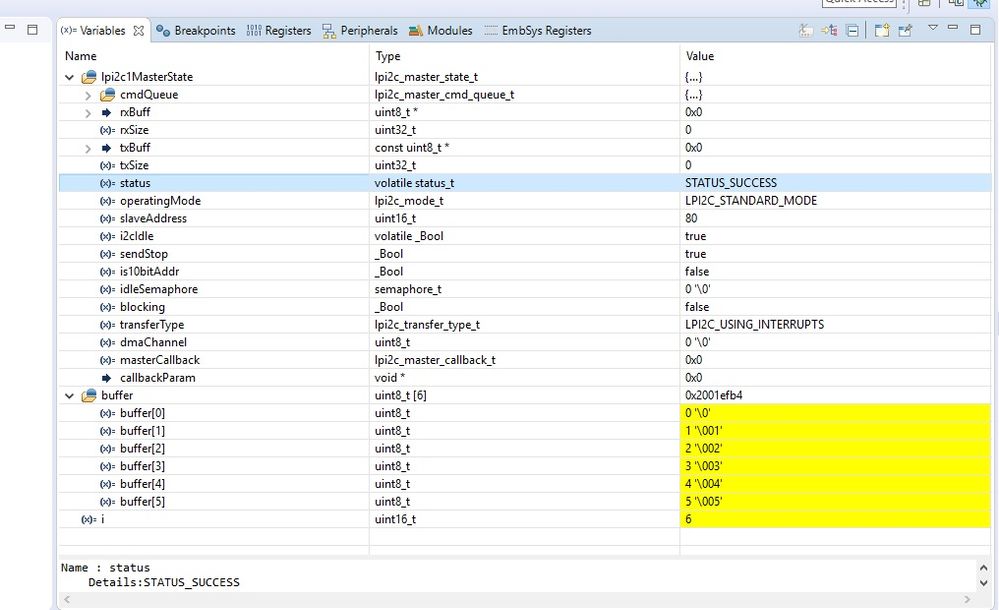

Hello ,
Currently  I am interfacing the Microchip 128bit EEPROM 24A00 , and after writing the content in to the EEPROM, the
reading of the same differs from what is written, when they are done one after the other as can be seen in the below buffer content
LPI2C_DRV_MasterSendDataBlocking(INST_LPI2C1, buffer, TRANSFER_SIZE, true, OSIF_WAIT_FOREVER);
Transfer Buffer
buffer[0] uint8_t 0 '\0'
buffer[1] uint8_t 1 '\001'
buffer[2] uint8_t 2 '\002'
buffer[3] uint8_t 3 '\003'
buffer[4] uint8_t 4 '\004'
buffer[5] uint8_t 5 '\005'
Clear Buffer
buffer[1] uint8_t 0 '\0'
buffer[2] uint8_t 0 '\0'
buffer[3] uint8_t 0 '\0'
buffer[4] uint8_t 0 '\0'
buffer[5] uint8_t 0 '\0'
LPI2C_DRV_MasterReceiveDataBlocking(INST_LPI2C1, buffer, (TRANSFER_SIZE - 1), true, OSIF_WAIT_FOREVER);
Receive Buffer
buffer[0] uint8_t 5 '\005'
buffer[1] uint8_t 3 '\003'
buffer[4] uint8_t 78 'N'

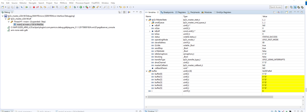

We make use of the below version and i have attached the code too.
S32 Design Studio for ARM
Version: 2.0
Build id: 170810
So could you please let know how to resolve the same.

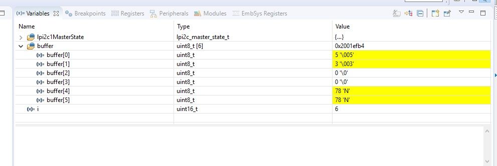

2,467 Views
satish_k_singh
Hello ,
thanks for the reply , the comment in the initialize buffer is not right , the slave address I need to set is 0X50 (80U in decimal) and I have done the same in the attached code , but i Still have issue with reading the content. I have attached the code and snapshot of the buffer.
I write 0, 1, 2, 3, 4, 5 into the EEPROM , but when i Read I get the value 5, 3, 0, 0, 78, 78 in the buffer.
/* Initialize LPI2C Master configuration
* - Slave address 0x50
* - Standard operating mode, 5000 Hz frequency
* - See LPI2C components for configuration details
LPI2C_DRV_MasterInit(INST_LPI2C1, &lpi2c1_MasterConfig0, &lpi2c1MasterState);
/* Initialize the data buffer */
for (i = 0u; i < TRANSFER_SIZE; i++)
buffer[i] = i;
/* Send a packet of data to the bus slave */
/* Clear the buffer to prepare it for the next operation */
buffer[i] = 0u;
/* Request data from the bus slave */
LPI2C_DRV_MasterReceiveDataBlocking(INST_LPI2C1, buffer, TRANSFER_SIZE, true, OSIF_WAIT_FOREVER);
/* End of the driver example */
