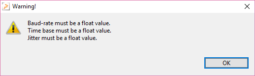

I'm not sure whether this is the right forum. However I'have the following problem with the Eclipse Plugin of the Freescale LIN Driver (I'm using FSL_LIN_2.x_STACK_4.5.4.exe):
If I open a previously saved LDF file and change from GUI editor to Text editor tab, I'm getting this message:
It's because the opened LDF looks so:
LIN_speed                        = 9.6 kbps; /* ----------NODE DEFINITIONS---------- */ Nodes {    Master:       LIN_MASTER,                                            /* Master node name */       10.0 ms,                                               /* Time base */       1.0 ms;                                                /* Jitter */
But if I change from GUI editor to Text editor, the tool changes the dots of the float numbers into commas:
LIN_speed                        = 9,6 kbps; /* ----------NODE DEFINITIONS---------- */ Nodes {    Master:       LIN_MASTER,                                            /* Master node name */       10,0 ms,                                               /* Time base */       1,0 ms;                                                /* Jitter */
If I would save the modified file (with commas), the tool can't open it again.
This all might be to do that I'm running this on a Windows with german language settings, however for me it seems to be a very annoying bug.

Our Eclipse team has reproduced this issue by changing format language to German. They confirmed this is an issue related to the higher versions of Eclipse (Juno, Mars).
However for CodeWarrior version 10.6.0 (tested with  the plugin) it does not happen.
We suggest to try one of workaround solutions:
Option 1.  Change Windows format language to English
Option 2. Use Code Warrior 10.6 that is the tool tested for FSL_LIN_2.x Stack package.
Option 3. Use another version of Eclipse e.g. Eclipse Modeling Tools Version: Helios Service Release 2,
     (download free at http://www.eclipse.org/downloads/packages/eclipse-modeling-tools-includes-incubating-components/heli... )
We will fix this limitation by always using LIN Specifications Standard format (use dot as decimal symbol).
This will be fixed in the coming release version 4.5.7 of FSL_LIN_STACK scheduled to be released in May 2016.
Thank you very much for your report!
Stan

my OS is Windows 10. And yes, normally I have a comma as decimal symbol. But even if I change it to comma this thing happens.
By the way, in my opinion writing to LDF must not depend from any language settings as the LDF is specified in LIN standard...

I'm using S32 Design Studio for ARM v1.0 build 150626 right now, but experienced this issue also with earlier versions of KDS.
Steps to reproduce this are very simple:
  • Open the LDF, it will be shown in Text editor by default.
  • Switch to GUI editor tab.
  • Switch back again to Text editor tab. In this moment the above shown warning comes up. At the same time changes will be done automatically in the Text editor as mentioned before:
I hope, this makes everything clear. :smileyhappy:
