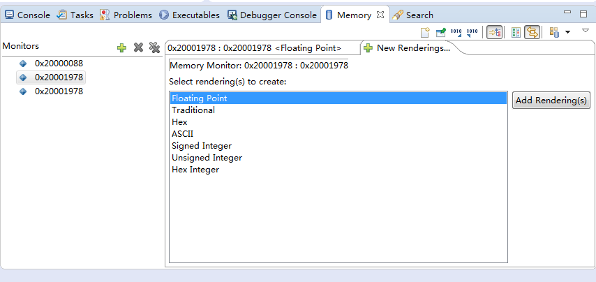

I use D32DS for ARM V2.0 to make a program for S32k144, I have a large of data of double type in the memory view, I founded the memory view can explain float data, but can't explain a double date. who can make it true, tell me plase.

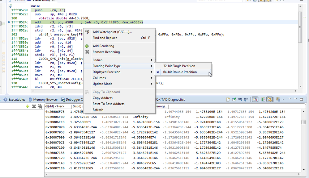

I find out that there is settings for switching float from 32bit resolution to 64 bit - right click on table number:
