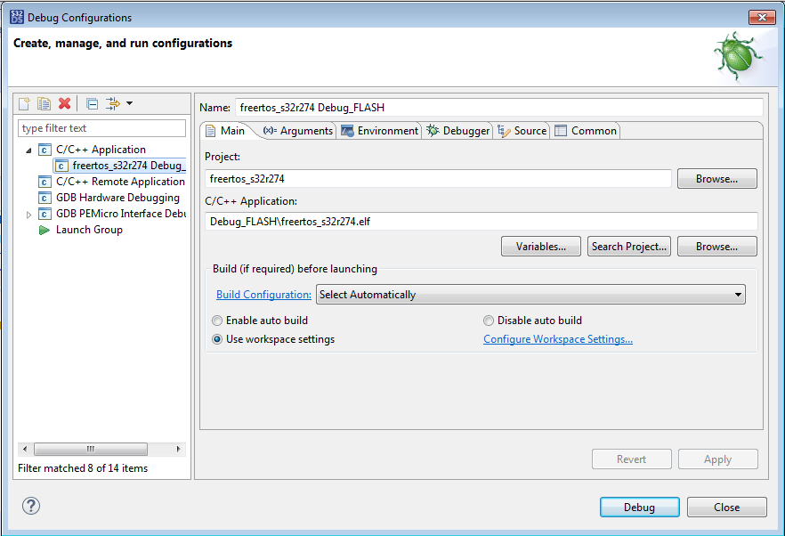

         I've created a new example project(freertos_s32r274:Debug_FLASH) in S32 design studio.
Could anyone help me in setting the debug / run configurations for the project without any Hardware connected(emulator).
If I choose C/C++ Application

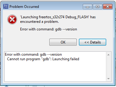

I'm getting this error
and also please provide information about run configuration so that I could able to run the generated executable(.elf) without any hardware and verify the gpio toggling and tasks running as required.

And can you elaborate on gdb debugging, why its throwing such error gdb -- version, do i need to change any PATH or need to install any software ?

the error is simply because you don't have installed gdb on your machine and even more - the build target (.elf file) is for Power PC machine.
Well, as far  as I know, there is no emulator/simulator available for S32R274.
Jiri

unfortunately emulator/simulator is not present in S32DS. You can't debug application without hardware.
Jiri
