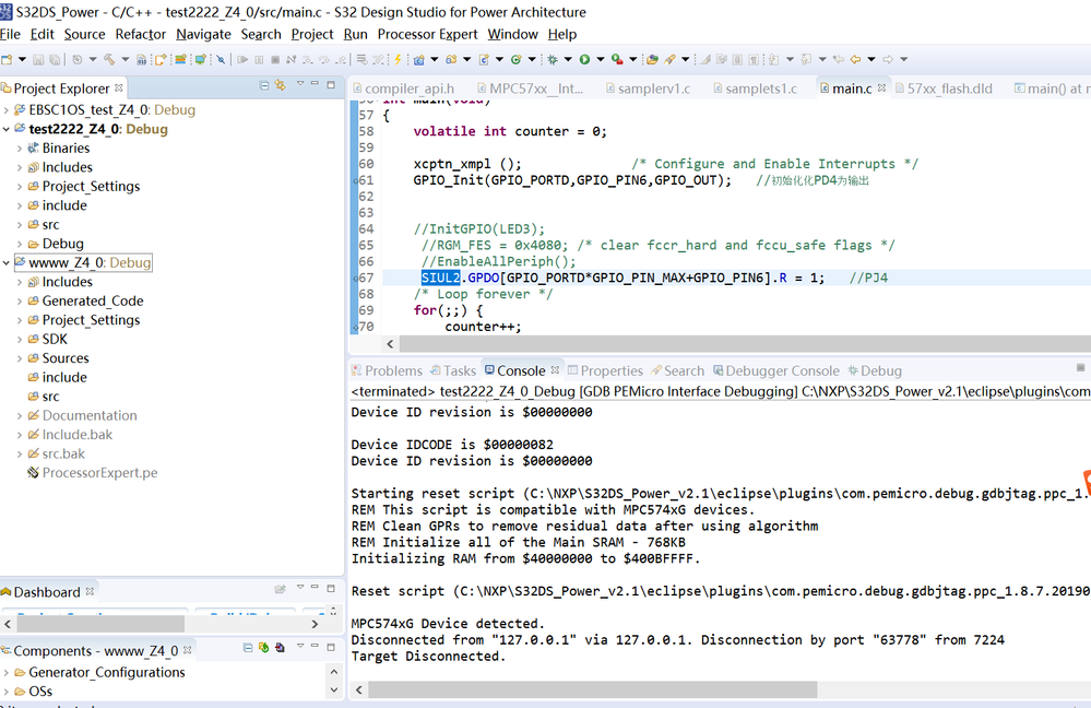

In S32DS project, you want to set the input/output configuration of GPIO, etc., but the Pin Library Settings are not available As is shown inQQ图片20210303091646.png

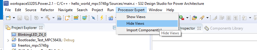

Hello @lubo_NEW ,

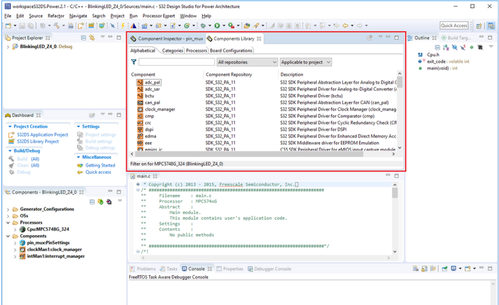

One way to make the view appear, select Hide Views from the Processor Expert menu, then Show Views. It should reopen the views for you. Otherwise you can manually add them from Window -> Show View -> Processor Expert.
