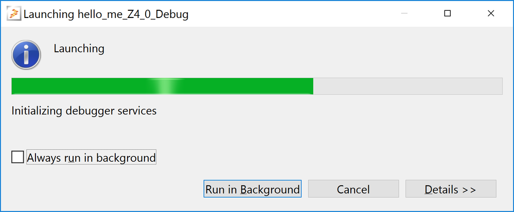

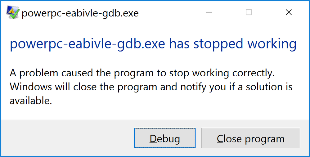

I am using an example C++ project from S32 (hello) for the DEVKIT-MPC5748G.
When I take the project as is, I can compile it and debug it, using the Diab compiler v.5.9.4.8 and the USB debug.
But when adding a class that inherits from another class, and declaring it as global, the debug fails.
debugger version: GNU gdb (GDB) 7.8.2

Can you help me sort out the issue? It seems like a but in S32 debuggger.

I found the root cause of your problem and it is called debug symbols. I had tried to load the code including debug symbols and the symptoms were the same as on you side. But when I had disable loading symbols, I was able to download code into the microcontroller.
So, at first, could you please check, if you use debug format DWARF 2.0? Because if you use some higher (3 or 4) it is possible that GDB cannot handle this and unfortunately it seems, there is some unhandled exception which causes GDB crash.
Also, could you please write me back all switches you use for compiling?
