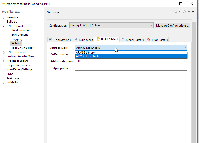

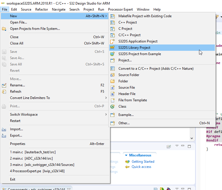

So, first of all - you need to select library project - if you like to build library:
Output will be library archive libYourProjectName.a . You can use your library in other projects just by adding it in project settings:
Also don't forget add include path for your library header files.

register names and other definitions are in Cpu.h for particular MCU. Just include this header file in  your project.
Easiest way how to setup all stuff is start with New S32DS Application project and switch it from executable target to library target:
