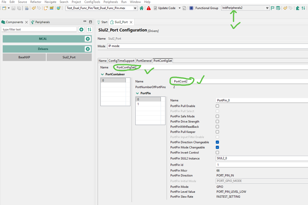

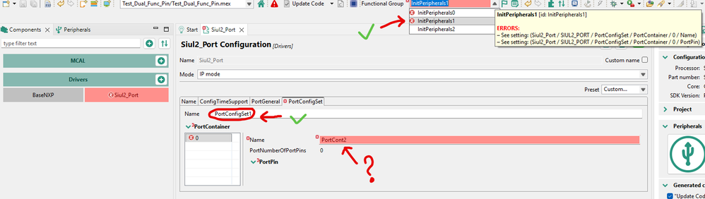

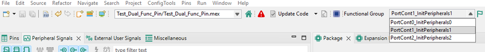

Thank you @Julián_AragónM  for your response, i tried and now i am facing a different issue, in below image i created InitPeripherals2 and configured the Pins according to functional group created in pins tool
but if i change to InitPerpherals1 i get error saying name and portpin are same, i even changed the config set names to PortConfigset0, PortConfigset1 & PortConfigset2.
I am a bit confused as to what went wrong. Here is my Pin functional group names.

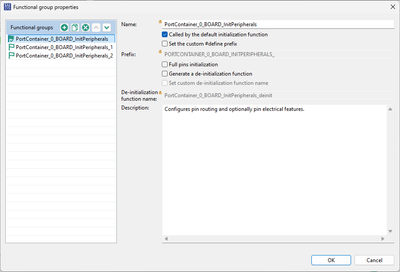

Hi @tj_78,

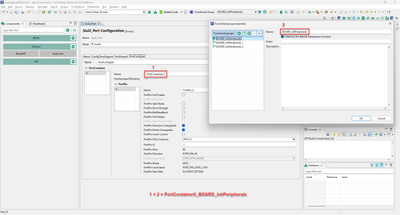

In order for the Port container to take the values from the "Pins" view, the functional group for "Pins" must be a combination of "Port Container name" + "_" + "Peripherals Functional Group name". For example, the default name for a project is "PortContainer_0_BOARD_InitPeripherals".
You can keep "PortConfigSet" the same for each one, as well as "PortContainer_0":
This way you can have 3 functional groups with different configuration for the same pin. I've attached the .mex so you can import it directly and see how to configure each functional group.
Julián

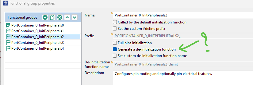

1. Is it necessary to de-initialize the current function of the pin before reinitializing it to other function?

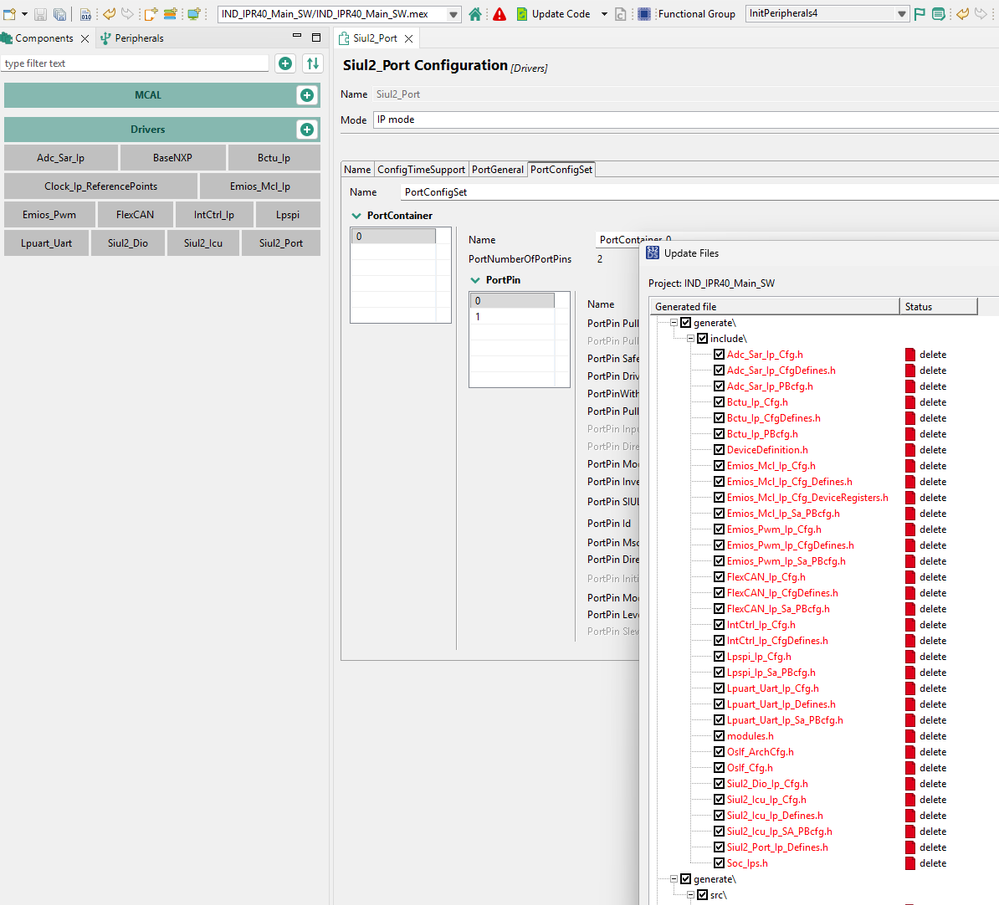

2. Also when i tried on my actual project i facing the issue of files getting deleted.
Before i split the Pin functionality into functional groups i already created the drivers and application, do you think i should clean the driver instances and add them on by one again?

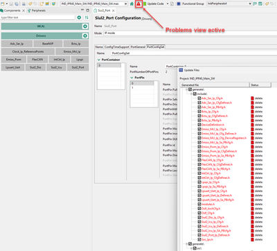

1. It is not necessary. You can simply initialize the next functional group, and the configuration will be overwritten.
2. I think this issue comes from a generated problem inside Config Tools:
Could you check if you have any active problems in either the Pins, Clocks or Peripherals tab?
Julián
