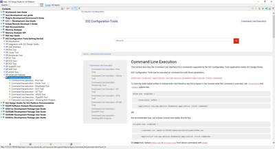

There is also a section in the "Help" menu titled "Command Line Interface" for different commands within S32DS:
Please clarify your end goal using commands without visual indications.

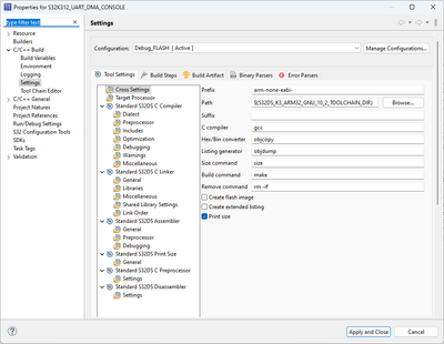

Also, the compilation tool is GCC, you can find the build command and C compiler inside "Project Settings":

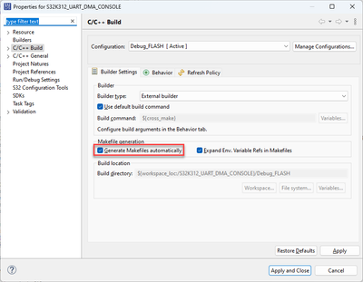

You can generate the makefile automatically when building the project:

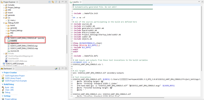

Hi Julián,
The makefile you mentioned is in the Debug_Flash folder and can be used for incremental compilation, but if it is lost after cleaning, it cannot be fully recompiled.
When recompiling after cleaning, there is no debug directory available.
