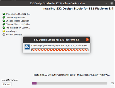

I un-installed S32DSV3.4 and Install again, but install stuck at Checking if you already have SW32_S32DS_3.4 license
21 Replies
10,575 Views
manju9401
I have tried deleting rm -rf /usr/local/share/macrovision/storage/FLEXnet/
Still the installation is stuck and not proceeding further

thosewhowish2b
I have the same problem, installer gets stuck at licensing, @ 6% progress.
Sudo does not help. Running within a terminal or not makes no difference. Sometimes it asks for sudo password, sometimes it asks for the activation code.
I'm on an Ubuntu 21.10. I had been using S32DS on an Ubuntu 20.04 thus far, without much problem.
Can someone take another look at this? I'd be glad to collect logs or whatever, just tell me what to do.

nxf47333
my PC is windows hot, per your suggestion, i deleted  C:\ProgramData\FLEXNet, and try to install again,
but issue is same, installing stuck at Checking if you already have SW32_S32DS_3.4 license

Could you please share the exact error message you are receiving? A screen capture is enough.
It could be an issue related to the version of the FlexNet Publisher included in the installer. Please go to https://community.nxp.com/t5/S32-Design-Studio-Knowledge-Base/Troubleshooting-Activation-fails-with-... and try the solution for error message #2. After this it may let you complete the install. Also, try to enable 'Windows 7 compatibility mode' before executing the installer EXE.
