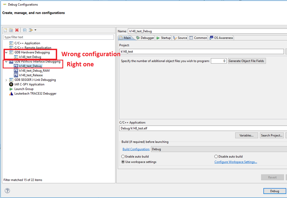

S32 Design Studio for ARM Version 2018.R1 program fail.
Error with command: gdb --version
Cannot run program "gdb": Launching failed

This issue may occur when the first debug is launched by clicking on the debug button and there was no debug configuration launched previously - Eclipse creates a new generic GDB configuration which is missing some important paths/settings required to run GDB client.
I'd suggest you to go the Debug Configuration dialog select correct debug configuration and press debug:
Hope it helps.

20,464 次查看
stanish
Hope it helps.
Stan
20,463 次查看
raphael_sommer
HI,
My Problem is gone now, thanks to you!
