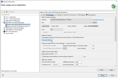

I have got a S32K148EVB-176 board and run some examples. The debug_flash setting won't work while debug_RAM works fine.
I have refered to below link, not working.
https://community.nxp.com/t5/S32-Design-Studio/Can-not-program-S32K144-EVB/m-p/963204
Any advice is appreciated. Thanks.

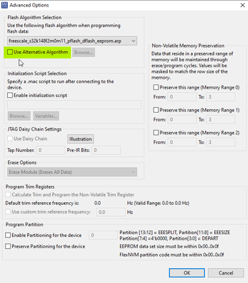

jiri_kral
please check in Debug configurations -> advanced options if you are using default flash algorithm:
Jiri
