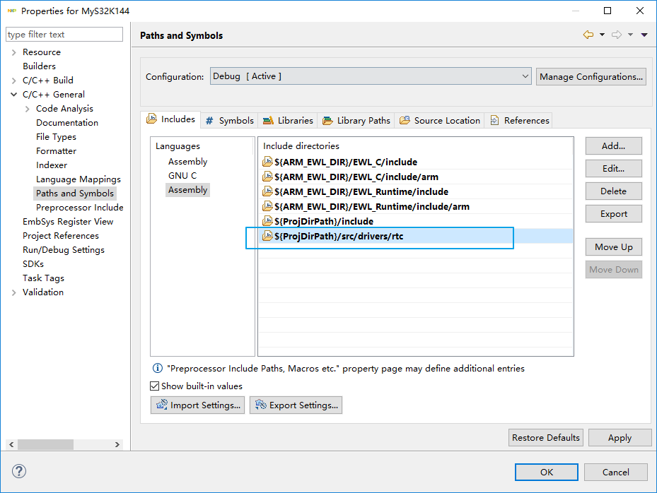

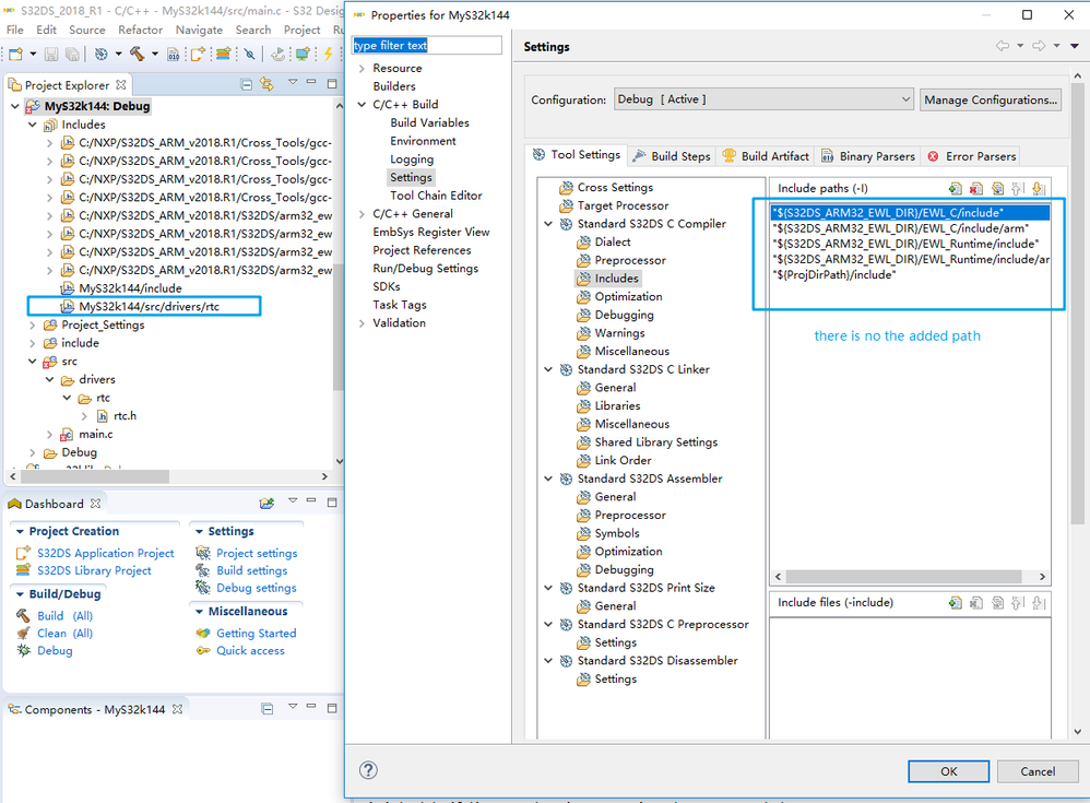

I am developing software on S32K144 by IDE S32 Design Stdio for ARM 2018.R1. But I can't include any header file after I add it to customized sub-directory. I don't know why. I can include the files for KEA128 using CW11 by the same way.
S32DS show the error message (Figure1): ../src/main.c:8:17: fatal error: rtc.h: No such file or directory.
Details:
1. Create S32k144 application project ;
2. Create my customized source file rtc.h, rtc.c , and add to ./src/drivers/rtc  (Figure1);

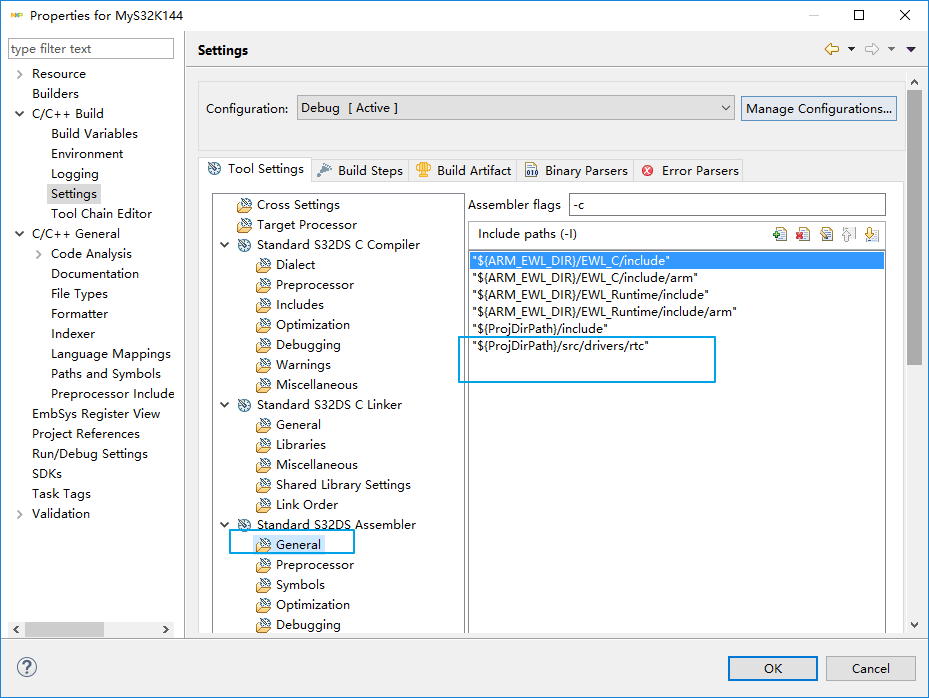

3. Add the file's path to the project (Figure2,3);
4. Include the .h file in main.c (Figure1);
5. Build , and then the error occurs(Figure1).
Figure1 Project File Structure and Building Error Message
Figure2 Add the Path to the Project
Figure3 Check the Path

jiri_kral
what about include paths? You need to add your path there too.
Also make sure, that your custom include path is shown and no grayed out in Includes
Hope it helps.
Jiri

fortunely
Hi Kiri,
There is no the added path in my project properties Includes for Standard S32DS C Compiler. After adding the path to the include path, it will be OK.
