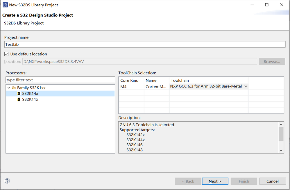

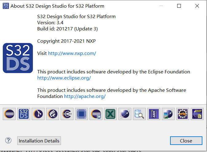

I need to use the static link library in S32DS v3.4.The compiler as shown below:
My operations are as follows:
1. First, create a project that can generate library files, and then compile to generate TestLib.a file,I use the default options during project creation;

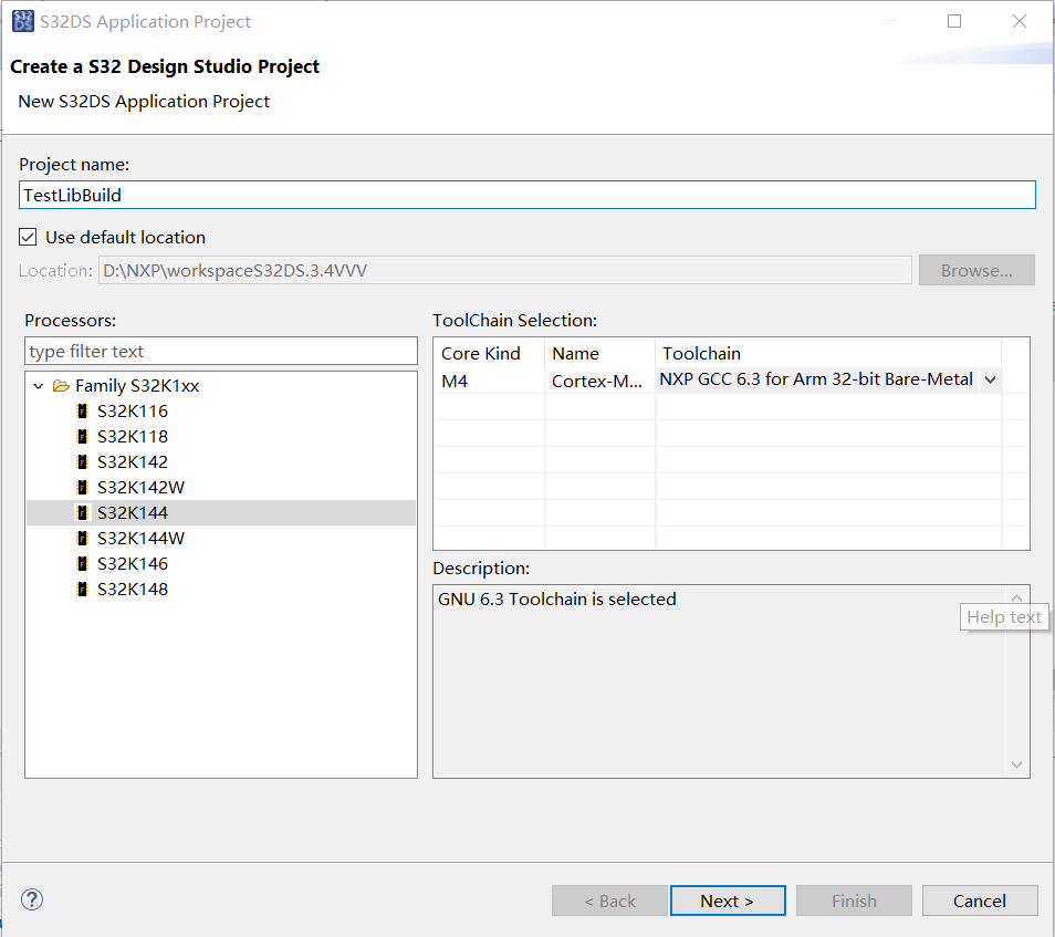

2. Then create an application project and add the above library files to the new application project,I use the default options during project creation;;

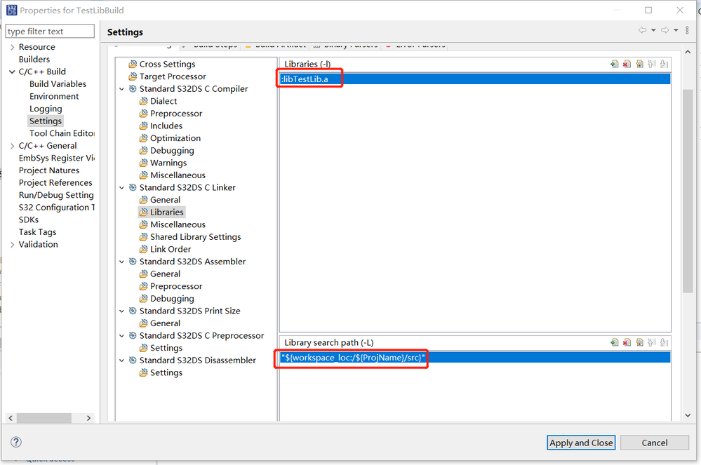

3.I add the LibTestLib. a file to the application project, and the settings are shown in the following figure

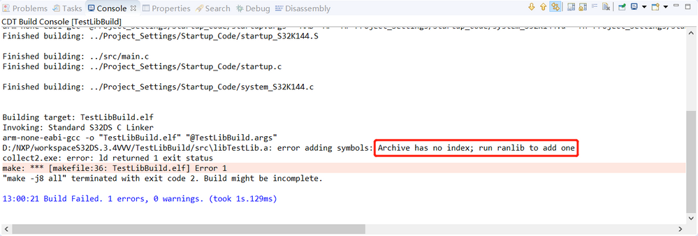

4. The following error prompt appears when compiling the application project.

arm-none-eabi-gcc -o "S32K144_Lib_BuildTest.elf" "@S32K144_Lib_BuildTest.args"
D:/NXP/workspaceS32DS.3.4VVV/S32K144_Lib_BuildTest/src\libS32K144_Lib.a: error adding symbols: Archive has no index; run ranlib to add one
collect2.exe: error: ld returned 1 exit status
make: *** [makefile:36: S32K144_Lib_BuildTest.elf] Error 1
