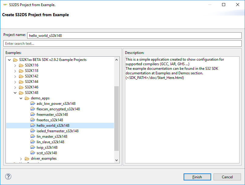

Hello kongdetao@saicmotor.com‌,
The latest update for S32DS for ARM Update 8 , contains BETA v2.9.2 of the S32K1xx SDK. Within this SDK are many example projects for the S32K148 which you can load into S32DS using the Create New Project from Example wizard.
Hope it helps,
Mike

kongdetao
Thanks, Mike!
        I have tested the example, it can't send can message on the S32K148 EVB Board, because the evb board has a transiver chip which wasn't configured correctly.
        So, whant I want is  an CANFD example on the S32K148 EVB :smileyhappy:
