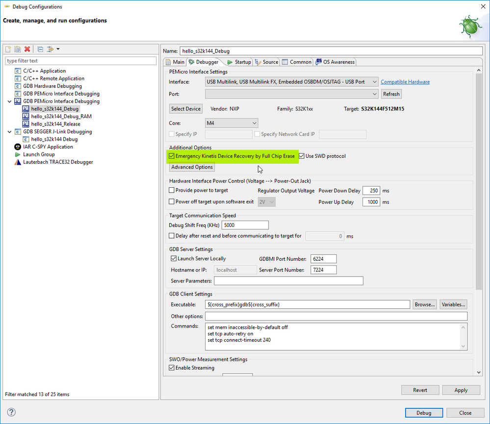

Have tried updating openSDA firmware and select the 'Emergency Kinetis...' checkbox. Not working.

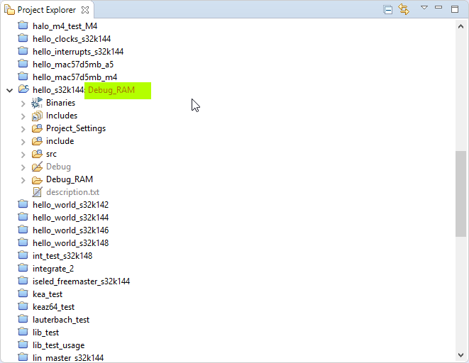

jiri_kral
are you able upload RAM target program?
You can also try Emergency Kinetis device recovery option in debug session confuguration:
