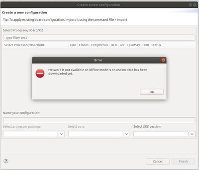

I installed S32 Design studio 3.4 on ubuntu and make project for S32K144.
and I try to use s32 configuration tool for pin or peripherals but tool shows errors following capture image. network works well.  How can I resolve it?

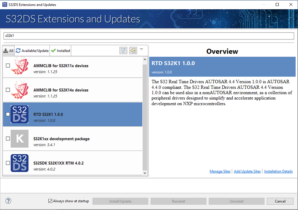

You are getting this error message because you are missing some required component. For best user experience, we recommend all S32 Design Studio users to install additional NXP-developed packages using the S32DS Extensions and Updates menu. This menu can be opened from: Help -> S32DS Extensions and Updates. To resolve the issue, please ensure you have the following packages installed:
1) S32K1xx development package v3.4.1
2) Either S32SDK S32K1XX RTM 4.0.2
OR RTD S32K1 1.0.0
