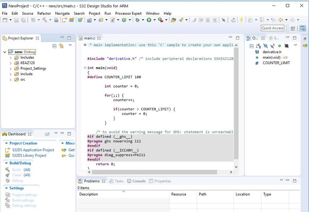

Dear Community,
Is Configuration tool (for pins, clocks and peripherals) available in S32 Digital Studio IDE for ARM platform ?
I'm using
S32 Design Studio for ARM
Version: 2.2
Build id: 200116

Hi emb02_jtronix,
I am sorry.
As far as I know: Configuration tool (for pins, clocks and peripherals) is not available in S32 Design Studio for ARM Version.
Configuration tool is available in S32 Design Studio for S32 Platform, but it seems still not support KEA series.
Robin

Thank you so much for your reply. Can S32 Design Studio for ARM platform will get updated with Configuration tool feature?

Robin_Shen
I'm afraid not.
If you want to use similar feature, you can use Processor Expert in KDS or CodeWarrior IDE.(But both IDEs were released a long time ago.)
If you need the project based on SDK, then I am afraid you have to use S32DS for ARM.(Processor Expert seems does not support KEA in this IDE.)
