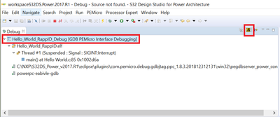

Since you have devkit  -> could you possibly try to attach to running target (Hello World project) after you program srec  using OpenSDA debugger?  this will help to figure out where the execution is.
Go to project Launch configurtation  and select "attach to running target" and press debug button.
Once the debugger connection is established, press Suspend/Pause debug button.
Can you send us the screenshot  of disassembly when you pause the execution?

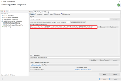

I'd suggest you to debug Hello World Rappid project (FYI: it should loads also program the bootloader - just update the absolute path to rbf file)

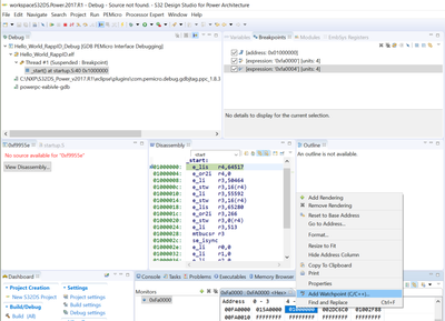

then put a breakpoint at app  _start() and perform reset target from the debugger (see screenshot below)
Now run the execution -> do you hit the breakpoint?
If not, please add read watchpoint to address 0xfa0004 (bootloader rchw block - app entry point) and reset from debugger. Do you hit the watchpoint?

when I put a breakpoint at app  _start() and perform reset target from the debugger, I didnot hit the breakpoint. the kit enters signal trap as follows,
when I read a watchpoint to address 0xfa0004, I got the following
then I reset from debugger, I got the following
