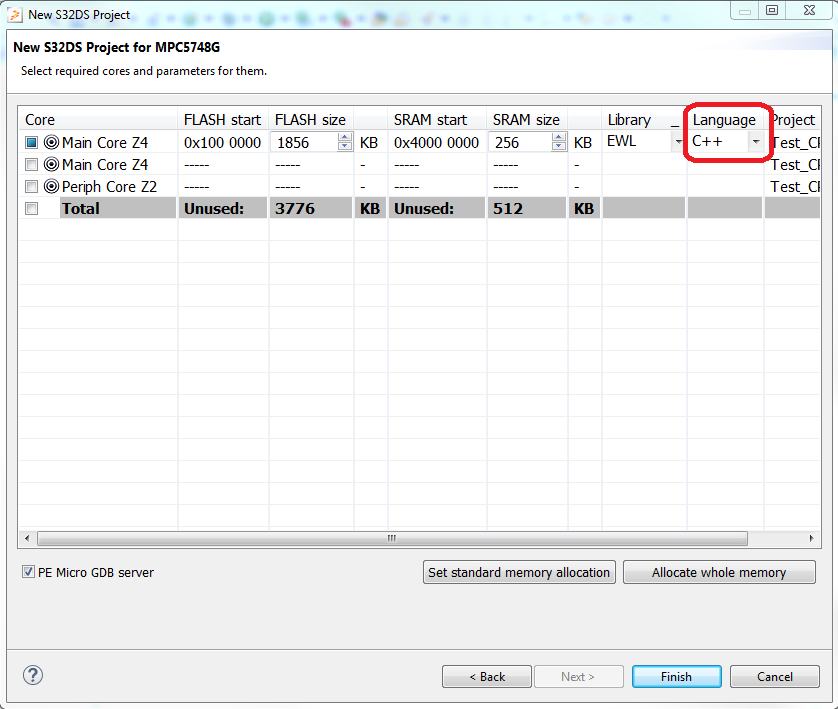

I have created an S32DS project for MPC5748G, running S32 design studio for power 1.0.
When I add a new C++ source file using template, the file is not included in the build process.
The new file shows up in the file tree but analyzis of the generated "Debug/src/subdir.mk" file shows that the new file has not been added.
The same thing happens if I try to import an existing file.
Adding a C-file from template works just fine.

Hello Ville,
Thanks for the additional details!
I'm now able to reproduce the issue you described.
It seems that you created a C project instead of C++ by the project wizard.
Such a project does not accept .cpp file as a source file and therefore there is no tool associated with .cpp file.
On the other hand a C++ project accepts both .c and .cpp source files.
I'd recommend you to create a new project and change the Language to C++ (see the screenshot below):
This project should accept .cpp files without any problem.
Hope it helps.
Stanislav

villevallinder
Hello Stanislav,
That was in fact the case.
It works fine now.
Thanks a lot!
