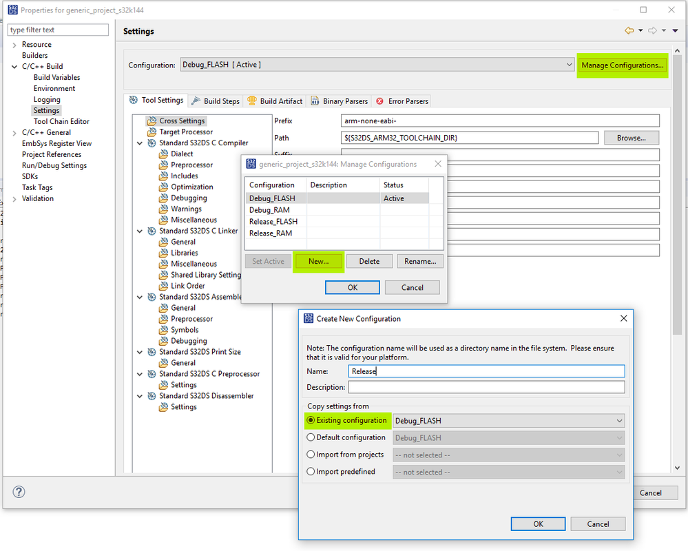

when i tried to switch from debug to release , i found there was no release option in the configuration drop down menu. i creat one by "create new configuration" ,but there is no symbol define in the symbol window,and there is no include path in the include path window which cause some errors , i fixed the errors by anding "CPU_S32K116" ,"START_FROM_FLASH" and include paths. but there are many "selected processor does not support `bkpt #0' in ARM" erros while compiling.
 the attachments are the details.
3,049 Views
jiri_kral
the easiest way how to create Release version is copy Debug configuration as it is and remove debug info. Right click on project name -> Properties -> C/C++ Build -> Settings:

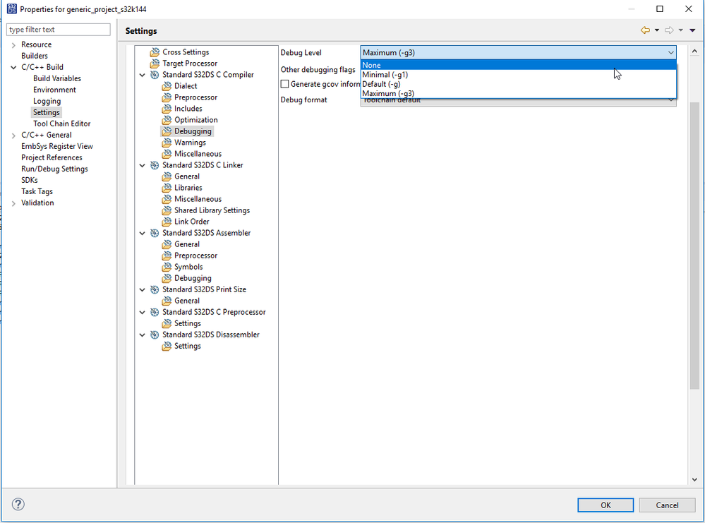

In newly created configuration set debbug level to none:

steven_zhang
Contributor V
hi jiri:
  i followed your guide ,copying a  configruation from the debug and mask the debug information by select none , compiling is finish ,but the code size is the same as debug configuration.
  steven
3,049 Views
jiri_kral
Code size (binary) will be same. Debug info is stored inside .elf file. With no debug info will be .elf file way smaller. Anyway - technically from MCU point of view - there is no difference between Debug and Release binary. You can also turn ON optimization - if you already didn't turned it ON and debug.
