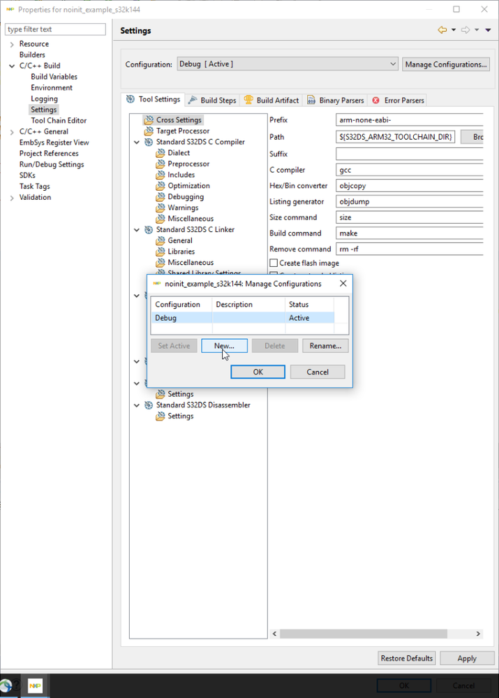

Hi NXP Team,
I have 2 version of S32K142 linker files (S32K142_32_flash.ld).
Each linker file has different memory area specifications.
I need to build 2 SREC files under the same project in S32DS with different linker files.
Currently, I have to perform the followings to build 2 SREC files:
1. Build the 1st SREC file.
2. Modify the linker file manually.
3. Build the 2nd SREC file.
I would like to know if there is any better way to achieve that.

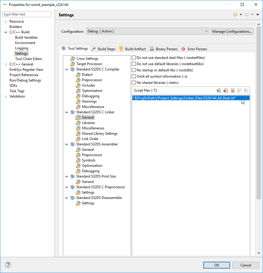

best option is just add another build configuration and specify your linker file in proejct settings for particular configuration - the same way as RAM and FLASH target:
Hope it helps.
