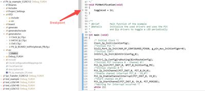

So I was using Pit_Ip_example_S32K312 in S32 DS v3.5
I didn't change any configuration of Pit_Ip_example_S32K312 before debugging.
I just set a breakpoint in PitNotification and ran the program.
Theoretically, the program should stop at the breakpoint, but it didn't. Why?
*The program could stop at the breakpoint set in main function but not the one in PitNotification.

It's RTD v2.0.1
Later I found that the interrupt actually works. If I leave the program running the LED blinks.
However, it just doesn't stop at the breakpoint when I'm debugging, it's kind of weird.
I guess maybe it doesn't recognize debug mode when I'm using a PEmicro. Probably it has something to do with my device?

please check the optimization level if it is set to none:
