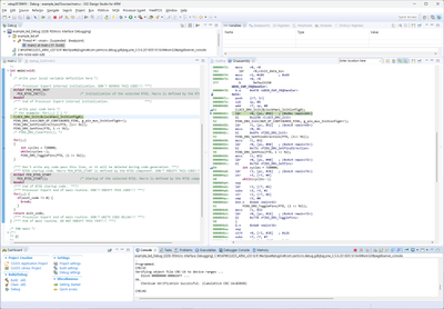

I'm creating and testing  a 'Blinking LED Example' project on S32K14WEVB-Q064 reference board refering to the follwoing url:
https://community.nxp.com/t5/S32-Design-Studio-Knowledge-Base/HOWTO-Create-the-Blinking-LED-example-...
There is no problem with creating the project, but when running in debug mode, execution stops at the CLOCK_DRV_Init function. Are there any separate clock or pin map settings required for the S32K14WEVB-Q064 reference board?

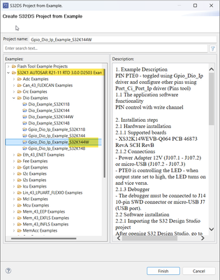

For development with S32K144W (or any other S32K1 derivative) we recommend to use the latest S32DS and RTD versions:
• S32 Design Studio 3.6.3 – Windows/Linux
• S32K1_S32M24X Real Time Drivers AUTOSAR R21-11 Version 3.0.0
To download IDE, go to S32 Design Studio for S32 Platform page -> Downloads ->
To download RTD, go to S32K1 page -> Design Resources -> Software-> Real-Time Drivers for S32K1 -> Automotive SW - S32K1_S32M24x - Real-Time Drivers for Cortex-M
Please check before Release Notes for installation flow/details to each SW.
Once you have installed SW, you could refer to project examples:

Could you provide us with more details?
1) version of S32DS
2)debug probe (e..g. onboard OpenSDA, external PEmicro multiling, segger....)
3) can you post a screenshot showing the code at CLOCK_DRV_Init() ideally including disassembly View.
Stan
2,180件の閲覧回数
cjwatgenicores
Please refer to my answer as belows. I appreciate in advance.
1) version of S32DS
S32 Design Studio for ARM Version 2018.R1
onboard OpenSDA
attached a screen catpture
