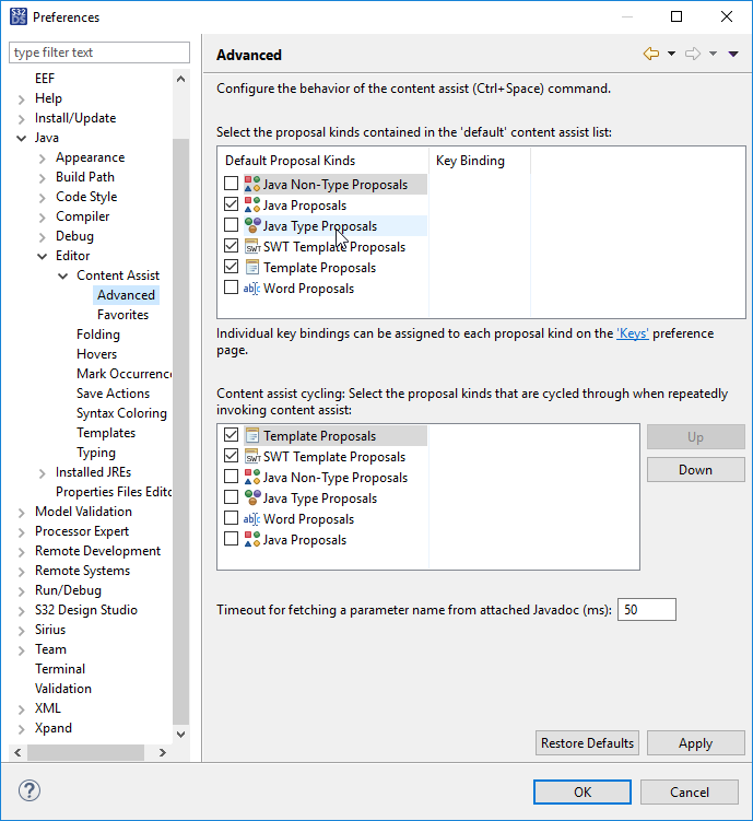

By default in S32DS one has to press Ctrl-space for autocomplete.
Go to the S32DS Windows menu -> Preferences -> Java -> Editor -> Content assist and checking the settings here.

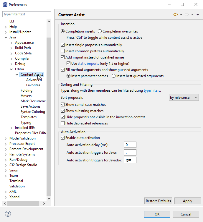

for me is Autocomplete/Content assist working normally. Here is my settings (default one - I didn't change anything):

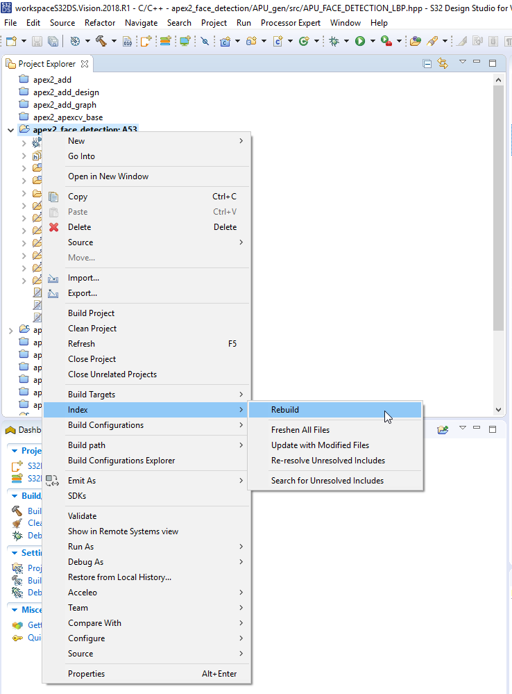

Did you try re-install S32DS or restart your PC Machine? May be there is no enough resources. Also rebuild index may help:

hanisamara
Hi Jiri,
i have S32DS for Arm V2018.R1 and i do not have the Java option, just C/C++ option. In this i found the content assist but without the 2 checkboxes for autocompletion, as you have in the pic above?
any ideas?
Thanks alot
