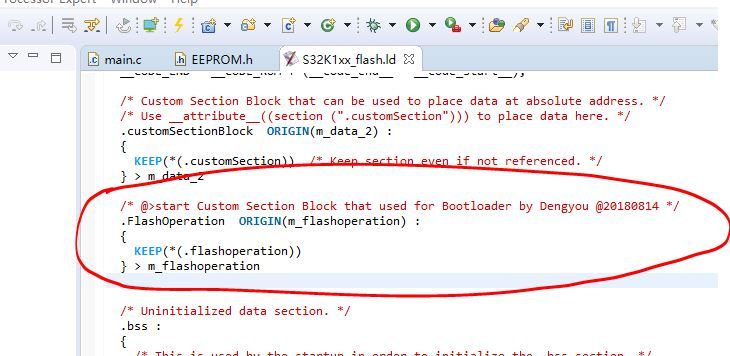

I've suddenly found that the .*bin file generated by IDE (S32DS) is too large,and bigger than the chip's capability after I put some code to SRAM_U (S32K142) by using *.ld file (Custom Section Block). See below:
Any solutions would be very appreciated.

Thanks for the additional details.

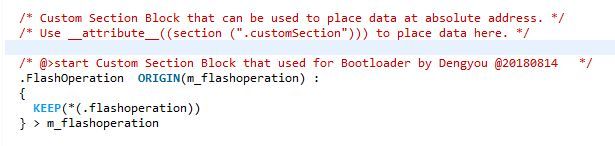

If the data in your custom RAM section (".FlashOperation") are not initialized you basically need to tell linker not to load the section.
This can be done by adding NOLOAD argument:
.FlashOperation (NOLOAD):
    KEEP(*(.flashoperation))
 } > m_flashoperation‍‍‍‍

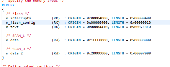

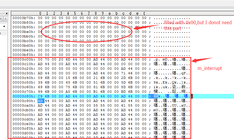

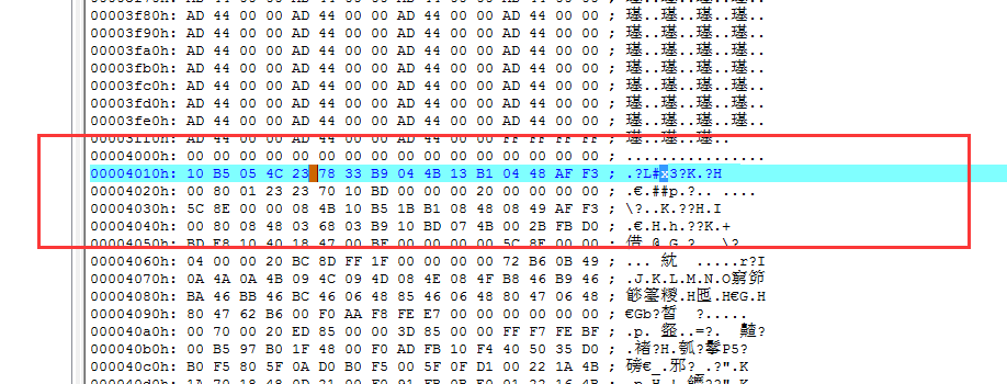

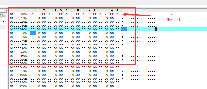

Hi Stanislav,
      I have solved the too big .bin file problem by your suggest.But I find the .bin file be filled with 0x00 for 0x0000 to 0xb000 at same time.(PS. I generate app.bin file for bootloader appcation,the start address of app code is 0x4000)
      How can I need to set for this problem? I need the app.bin code start at 0x4000.
BTY, I find the m_interrupts in 0x3c00,the m_data in 0x4410.This circumstances different with my config.
