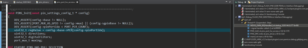

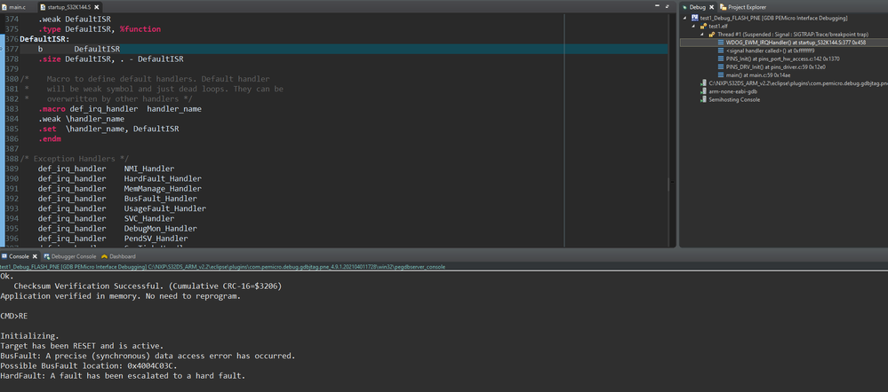

In every instance, the issue happens when initializing the pins using PINS_DRV_Init().  More specifically, when pins_driver.c calls PINS_Init(&config[i]).  It jumps to pins_port_hw_access.c then to DefaultISR.
All I'm trying to do is flash an LED at this point.  Everything is left default except for setting up 2 GPIO pins as outputs (PTE8 and PTD15).
If I comment out the pin init, the program moves through normally, though nothing happens because the pins aren't setup. If I manually set the pins up, it faults when I call PINS_DRV_SetPins().  If I manually set the pins, it faults there instead.

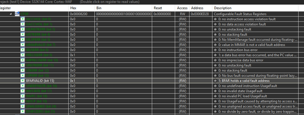

danielmartynek
Hi @sparkee,
Can you first identify the fault following this example:
https://community.nxp.com/t5/S32K-Knowledge-Base/Fault-handling-on-S32K14x/ta-p/1114447
Is it really a bus fault?
It seems like there is no problem to write the PCR_MUX and switch it to an output.

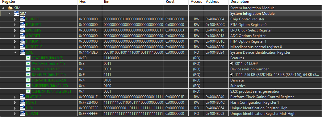

Anyway, you mentioned that the source of the MCU was shady.
Can you read the SIM_SDID System Device Identification Register?

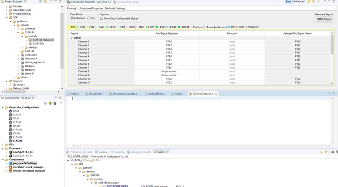

I have it as a watch and it is STATUS_SUCCESS until it hits that line, then it switches.
My coworker noticed that when changing from 146 processor to 144 processor then generating PE files, the SDK file S32K144_features.h file generates empty.  When generating the 146, the features file generates correctly with clock enable information and the program runs correctly.
9,332 Views
danielmartynek
I don't know why the file does not get generated.

SDID looks ok as far as I can tell, though I have very little knowledge of this.
9,476 Views
danielmartynek
The SDID register looks correct for an S32K144 MCU.

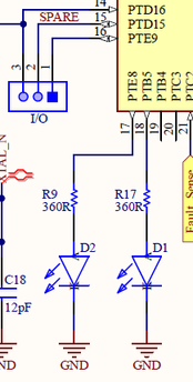

As for what is connected?  PTD15 is connected to a female header as a spare pin and PTE8 is connected to an LED.

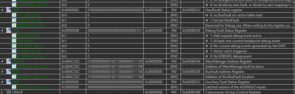

Thank you for your reply @danielmartynek.  A strange thing has happened.  I built a second board and got the same error.  I scoped PTA5 and I see 5V except for a quick reset when loading the program.  The first time I did it, it through the fault like normal and I saw nothing on PTA5.  The second time, I moved scope to PTD15 and the board is actually running fine and no fault.  I added code for PTE8 to be an output and the LED is also blinking.  I was even able to switch back to the SDK code instead of setting registers manually.  I was able to remove the probe from the board and continue running fine.  I switch the first board back in, no change to code, I get the fault again.  See below for register values.
I was pulled into something else but now back to the first board which was working intermittently and now I can't get it to work.  No code changes.  Tried probing but no change.  PTA5 not resetting, holding 5V after initial programming.
I'm not entirely sure I know what you wanted me to do after reading your post you linked me to, other than looking at the registers above.  Was there something more specific I should have done?
