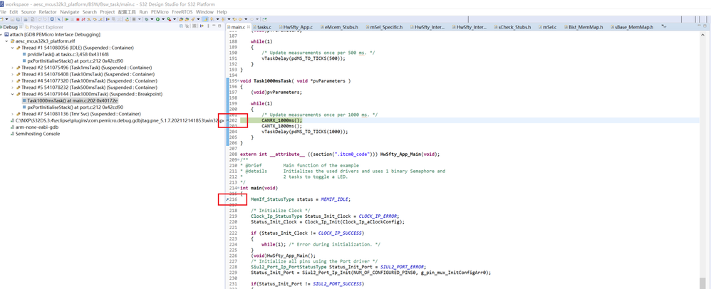

Because I need to know how some functions are running during a cold start, I used the attach function.
After debugging and using "attach running target", clicking restart cannot return the software to the initialization stage.
My debug settings are as follows:
Set a breakpoint in the running phase and initialization phase, and then click restart. The program skips the breakpoint in the initialization phase and stops at the running phase Task.

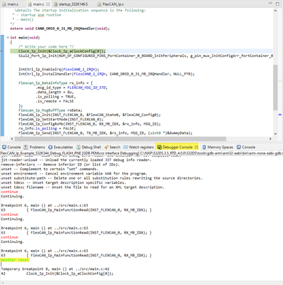

Hello, this method is not successful. After many tests, this method is only effective when the program stays in the initialization phase. At other times, it will cause the debugger connection to be disconnected.Snipaste_2024-05-22_13-57-44.pngSnipaste_2024-05-22_13-57-44.png
3,562 Views
Julián_AragónM
Hi @Janeting123,
Could you clarify how you tested this? I can see the command working correctly when being in the while loop from this example:
Then issuing a "monitor reset" I can see from the console that the CPU has been reset by debugger back to the initialization breakpoint in main():
Even if this doesn't work on your side, this is unfortunately out of scope for the community support as the implementation of the restart and resets from the debugger comes from the PEMicro implementation. I apologize for the inconveniences.
