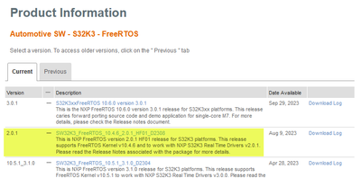

lukaszadrapa
Hi @Rab06
FreeRTOS packages can be found in S32K3 Reference Software package:
https://www.nxp.com/webapp/swlicensing/sso/downloadSoftware.sp?catid=SW32K3-REFSW-D
S32DS for ARM does not support S32K3 devices, use S32DS for S32 Platform instead.
Lukas

Rab06
Thank you.
I found this link on the same way with installation details : https://community.nxp.com/t5/S32K/S32K314-try-to-build-a-project-with-freertos/m-p/1516169#M17482
