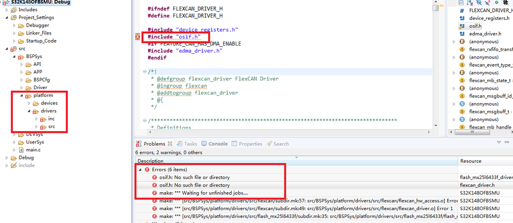

hello,
I get the platform file from the installation path of S32DS.
Added to my S32ds project, compile appears
In this platform file, I have added the include path, but the project can't find this file.
Excuse me, where is the osif.h file or what is the use, why is this file contained in the underlying library?
Thank you

I'm not sure what is your goal. The osif.h  (and also platform ) is part of SDK - ( located in S32DS/S32SDK_XXX/rtos/osif/osif.h ). Your project doesn't look that is using SDK.
Can you please describe in more detail what you are trying to do? Thanks.
Jiri
