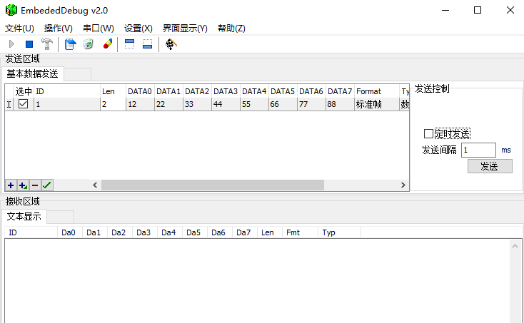

the tool I used to get and send the frame message

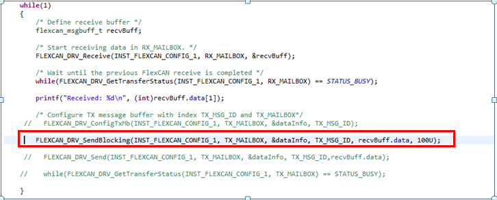

the send function which  is not working normal is show below

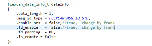

it turns out the configuration of the dataInfo is not rightly set,after I change the setting of the dadaInfo as below shows ,sending function became normal
