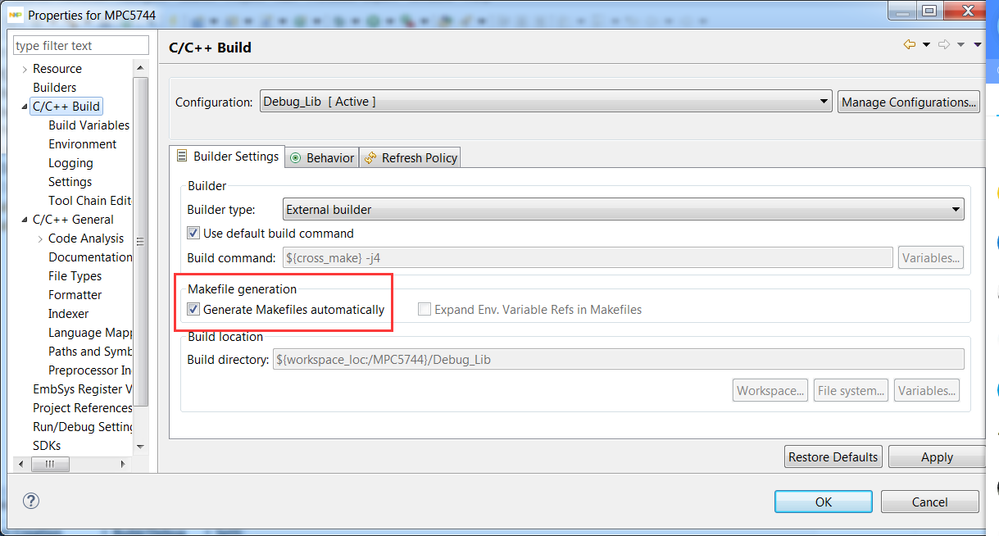

What is the dos instruction for automatically generating makefiles in S32 Design Studio for Power Architecture Version 2017.R1?
I want to know if there is a cmd command, external software can call the command, and automatically generate these Debug files

This option causes that the makefile(s) for your project are generated automatically when you build the project. (See the output directory for auto-generated makefiles)
In such case you don't have to maintain makefile(s) when you e.g. add any source file to your project or change the project structure.
Hope it helps.

You can build your project from command line, including makefile output - here is thread related to command line build:
https://community.nxp.com/thread/453706
I'm afraid that there is no standalone tool for generating makefiles only.
