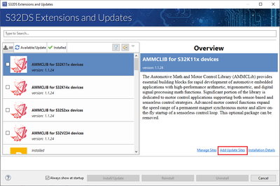

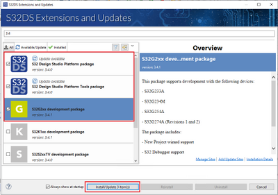

The update is available for online (via Eclipse Updater) or offline installation
  •  online installation:
    • go to menu "Help" -> "S32DS Extensions and Updates" dialog
    • select from available items and click "Install/Update" button

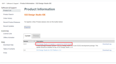

  • offline installation:
    • go to S32 Design Studio product download page: S32 Design Studio for S32 Platform -> Downloads, click 'Download' button next to S32 Design Studio 3.4 -- Windows/Linux
    • from the Product Information page, select S32 Design Studio 3.4 Update 1, support for S32G2 family
    • then select 'SW32G2_S32DS_3.4.1_D2104.zip' to download the update archive zip file
    • Start S32 Design Studio and go to "Help" -> "S32DS Extensions and Updates"
    • Add the downloaded archive as a software site. Click "Add Software Site" and browse to select the archive file downloaded in the prior step
    • Select from available items and click "Install/Update" button.
This will start the update installation process.
